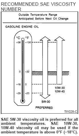

Home during lunch and quick scanned the owners manual,,, but could not find that graph I've seen some other manufactures use. I know I'm missing something but your right, they should have another weight on there. Any idea which page? I have an 05.
Old Dec 12, 2007 | 03:39 PM
  #22
Gilley's Avatar
Joined: Apr 2004
Posts: 8,001
From: Orlando, FL
Originally Posted by Jeff92se
I "think" there are temp recommendations for each of the two weights they recommend?
Here you go.
Attached Thumbnails I have 67,000 miles. I live in the South. What weight oil should I be using?-viscosity.jpg
