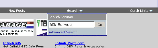

btw, next time try the search feature:

Thanks guys, I live in Orange Ca.
I searched 60,000 service and nothing came up .
Must have searched wrong or something.
Thanks for the welcome this forum is great.
