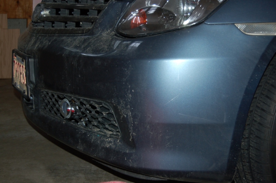

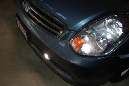

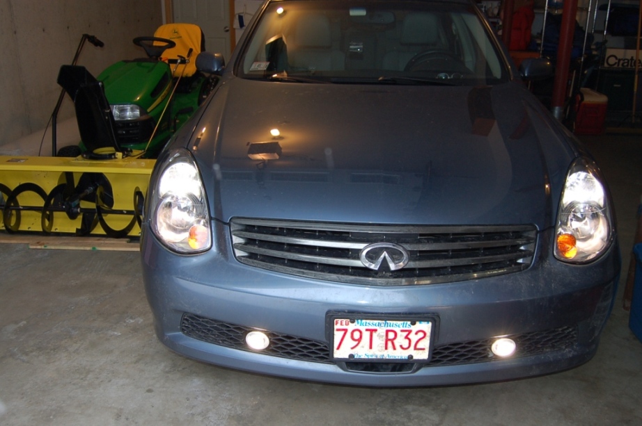

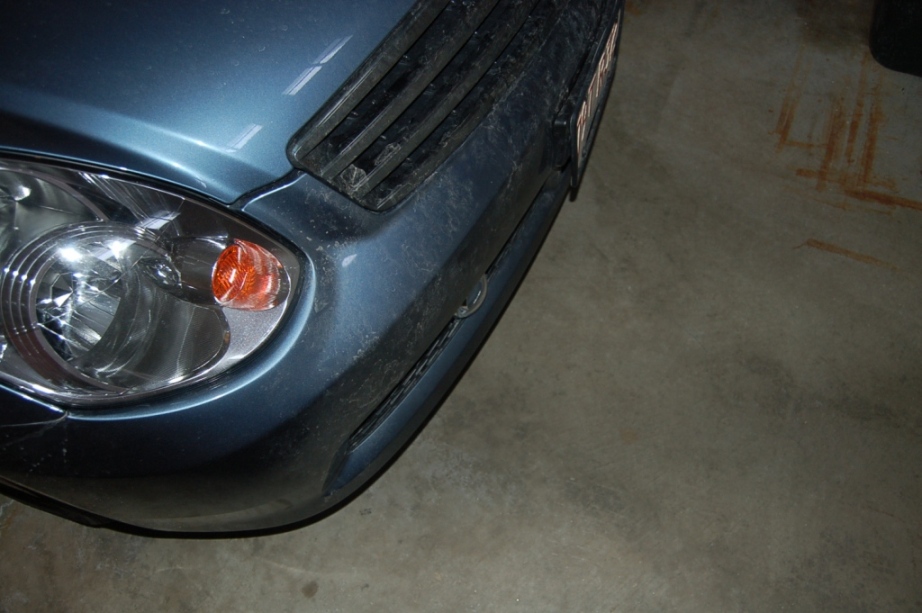

So I am a bit of a nut about quality lighting. I have had lasik, so it really isn't bad eyesight anymore. Just love bright headlights.
I have again caught the modbug and this is my latest creation. These are PIAA P-1000XT with Platinum Extreme bulbs (same bulbs as my fog/high beams, so the color match is perfect and are much whiter than the pictures.) Took about 4 hours all in to do. Just had to remove the plastic protector panels under the car, drill the aluminum bumpers, custom build the spacers so they sit perfectly and run the wiring.
I know the car is a mess, but A.) I live in Massachusetts and it has not stopped snowing since November. B.) I am getting new wheels and a drop in the next few weeks, so I will resend pretty photos. I was just pretty fired up about how well this turned out and wanted to share.
Attached Thumbnails Day light at Midnight-g35-fog-lights-0002.jpg   Day light at Midnight-g35-fog-lights-001.jpg   Day light at Midnight-g35-fog-lights-005.jpg   Day light at Midnight-g35-fog-lights-002.jpg

looks good, did u wire them to come on with the headlights?

jaydafunk: Yes. I wired the switch to the headlight line, vs the recommended highbeam line. When I hit the brights, they switch off.

I like the shot but you forgot to blotch out your license plate in the reflection LOL.

I like that too. I tried to match the lines on the hood and front grill to figure where I wanted them. There was no way I was going to get mine in that spot unless I took the front bumper off.
