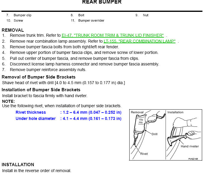

Does this help?
how to remove rear bumper?-bumper1.jpghow to remove rear bumper?-bumper2.jpg
