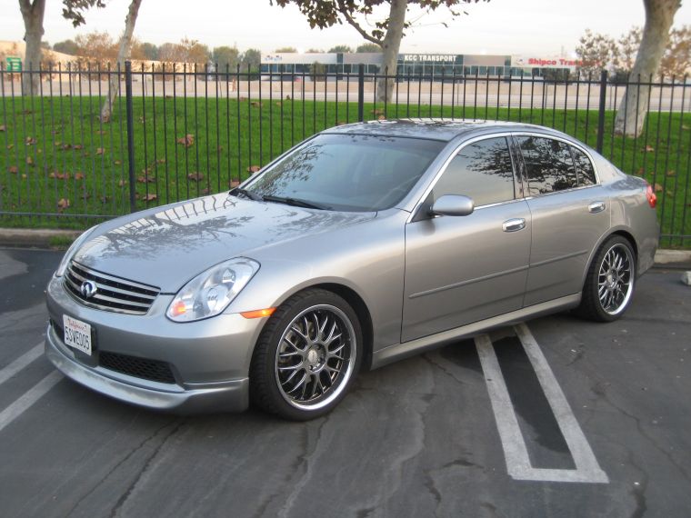

Im running H tech springs that gift it that look, but like he someone said it's barely .07" in the back, the federal that im running are 25.5" in height were every other tire is 26.6 or taller. I hate the gap in the rear but love the ride and Im always driving 3 deep so the back drop to compensate. I want the coil-overs just waiting to get that awesome deal, heres my pic.
I want the look but Im afraid of ruining the ride, Do the 350 springs drop it any lower than the h, I might be interested
