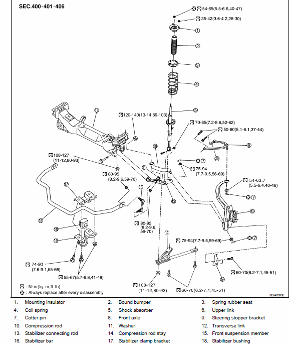

are they about $40 each for the bushings? I need to replace both my lower control arm bushings. Where can I check a diagram that shows the compression rods and Lower control arms?...I just want to make sure I have them right.
Here's a screen grab of the 2004 sedan front suspension. If you need a clearer pdf, then PM me.
