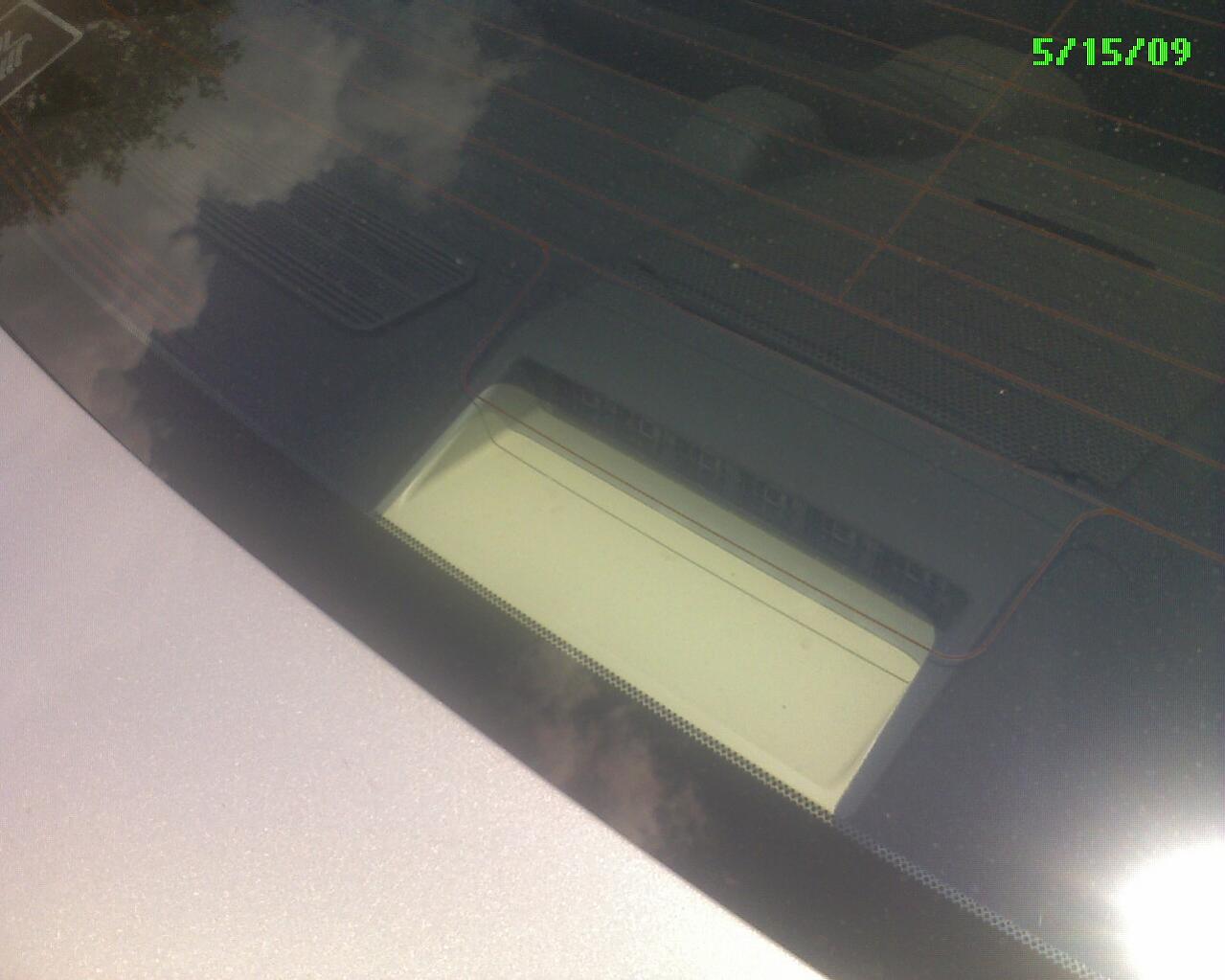

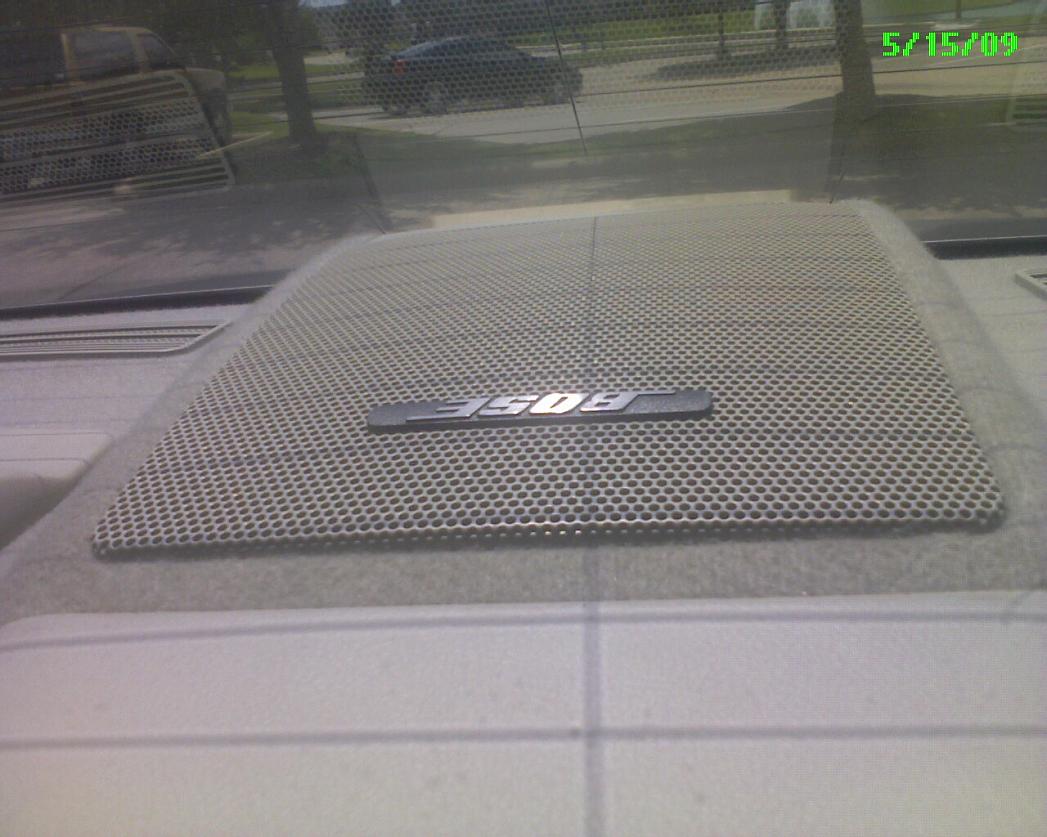

So I have noticed even some 05-06's with a failing or dead center high-mounted stop light (the LEDs that are on the parcel shelf in the back windshield). My 03 sedan did the same thing, and for a while I found that hitting the back windshield where the light was made it come back on. When my Bose sub crapped out and I replaced it, I disconnected the CHMSL and when I connected it back VOILA! it was fixed! So before you replace the circuit board at the stealership (Sewell has it listed at $146.21) try this.
Remove the plastic honeycomb cover thing where the sub is (I haven't seen what this looks like in a non-Bose car) there are some clips and adhesive so be careful not to break it like i did!
Unplug the wiring harness that goes to the lights and re-secure it firmly
Replace the honeycomb thing and you're done!
NOTE: this does not pertain to the LEDs in the optional spoiler.

those speaker covers are a biatch. remove rear shelf if you dont want to break anything.
rear seat bottoms, backs, C pillar trims. pull up on the shelf to release the pressure clips, then out. it will get snagged on the seat belts anchors. you dont have to remove those.
