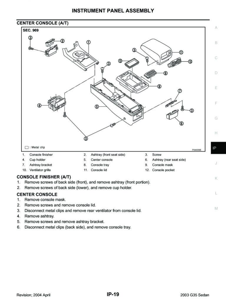

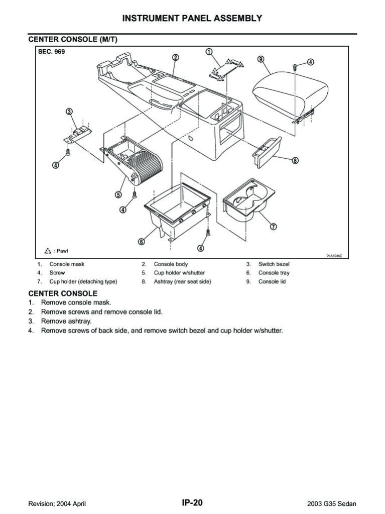

Yeah, the AT and MT are different. This should help some:
Attached Thumbnails Need any custom interior modifications???-ip19-copy.jpg   Need any custom interior modifications???-ip20-copy.jpg

Those pix are RED x's.....
Its weird cuz blkonblkgsedan's G35 is either and 03-04 and his is an auto and his armrest doesn't have vents on the back, the picture I put up with the vents is for an AUTO g35 sedan.... wth I'm confused! lol I need more guys to chime in!

ok I just attached the pictures.

For some odd reason blkonblkgsedan has different style then both of the ones you posted up NFSP1, he has an auto and his is either 03 or 04 but he has an armrest that looks similiar to the Coupes but its different. Do you have schematics or the install sheets that u posted for a coupe?
