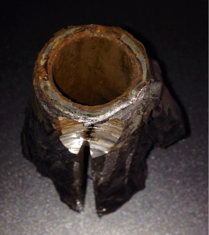

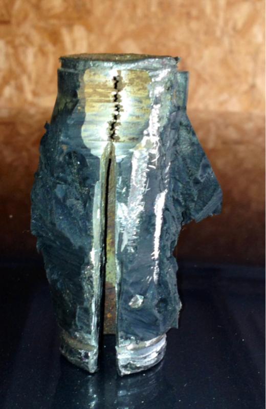

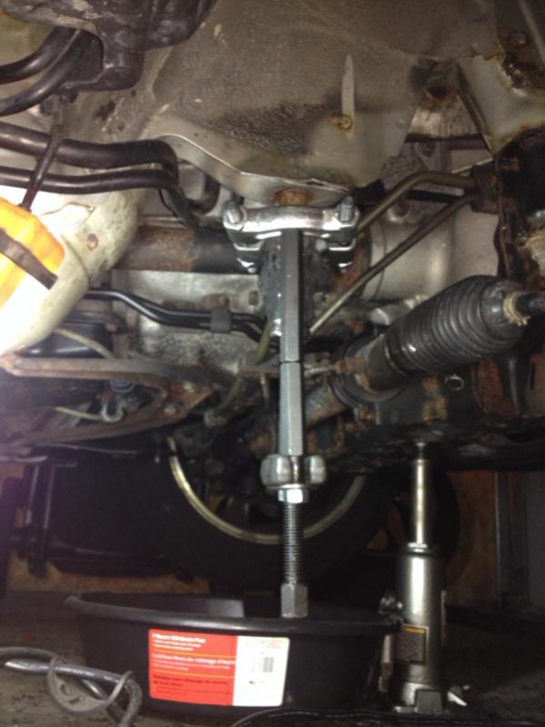

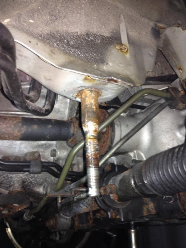

I had to do this too, but I didn't torch it. I drilled through the rubber bushing and removed it by pulling it out with a needle nose plier, cutting through it with a flat head screw driver and tearing it apart by prying down the rod. Like nemises, I had to cut the sleeve, but I just cut one side as far up as I could. I used a chisel and separated the sleeve from the bolt. Then I used a bearing puller to pull it off. I cut grooves at the bottom of the sleeve first to pull it off, then pulled it from the top of the sleeve when I had enough room. It came out pretty easy with the bearing puller, highly recommend it. Here's some pics.
