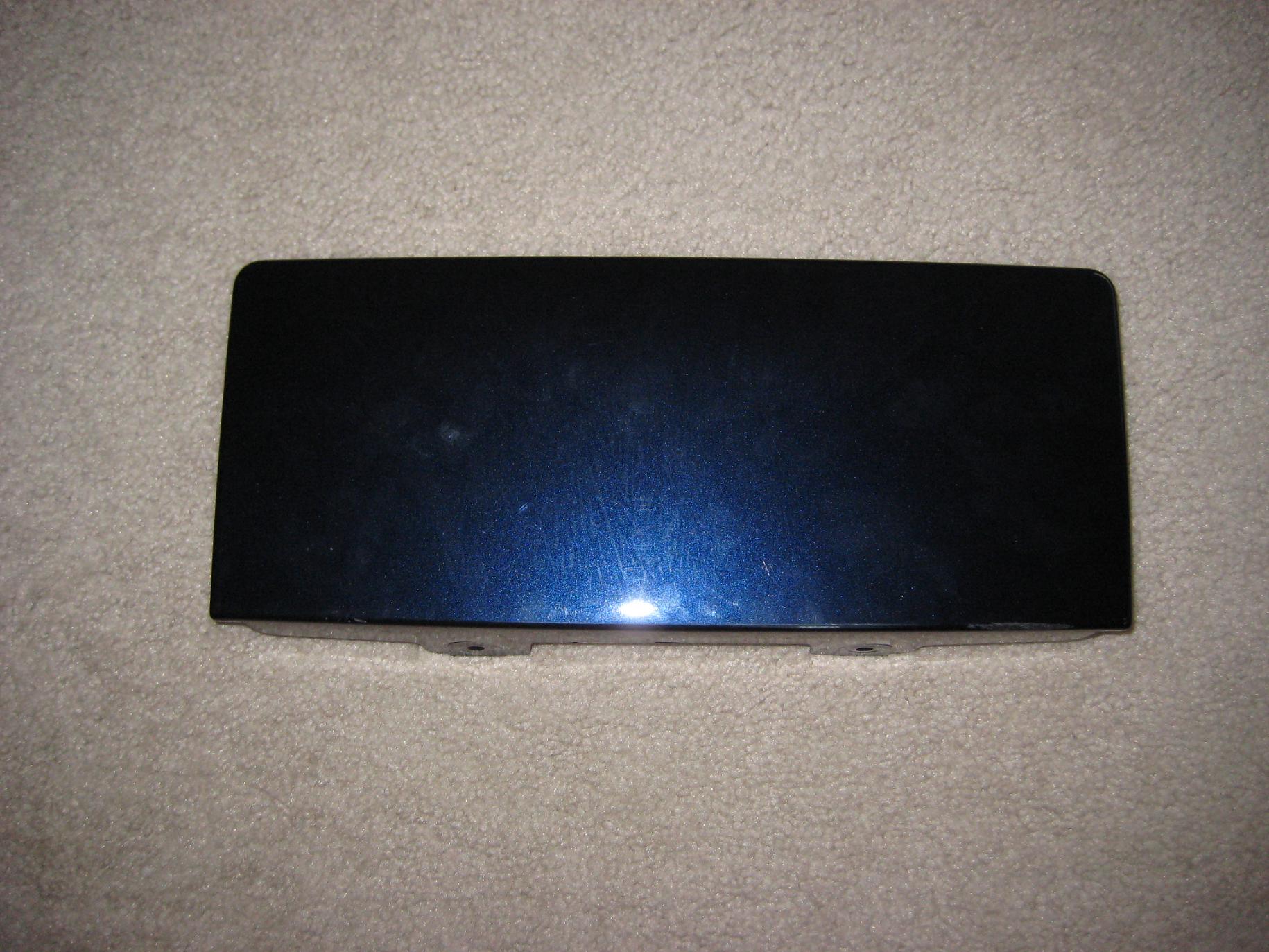

Pics attached ..... the 2 plastic things that stick out have nowhere to snap in or go .. should I just remove them ? or am I missing something ?
Thanks

may soind stupid but are you puting it in upside down?

Your tab might be broken I had to ghetto mines yesterday for the mean time and duck tape it from the back.

To put it upside down you have to be braindead .. there is no way to put it upside down.

I wish I had this problem too...but I am sure that there are TWO different plate covers for the sedans. I do not know how to tell the plate covers apart though. The nismo cover is different from the regular sedan bumper plate. You may have the wrong one for your ride. NOT to turn this into a FS or WTB thread but I am in need of a Brilliant silver NISMO plate cover (will paint if need be) if anyone has one. Thanks and good luck with install.

Okay so i picked up the part today and it did come with those tabs.
However, I think i MIGHT HAVE figured out what the problem is with yours.
Where the tabs are supposed to go, it seems like theres nowhere to put them, but actually theres a black foam, if I'm not wrong about your G.
The holes for the two tabs are cut out of the foam already.
They should be all the way at the top. (They're hard to see)
Just slide the metal brackets that hold the bottom screws into place before you try to install the piece,
then slide the tabs into the ALREADY CUT OUT holes in the black foam. After that you can push the bottom in, and just slide in the screws and tighten them.
I hope this helps? Let us know!

incubus3612 is 100% correct and thank you, because I just went out and corrected mine..as I too was going to break the tabs off for the same reason as the OP

getting a replacement part could cost up to $100 so its a good thing you didn't break yours
that's how much i paid for mine from the dealer
