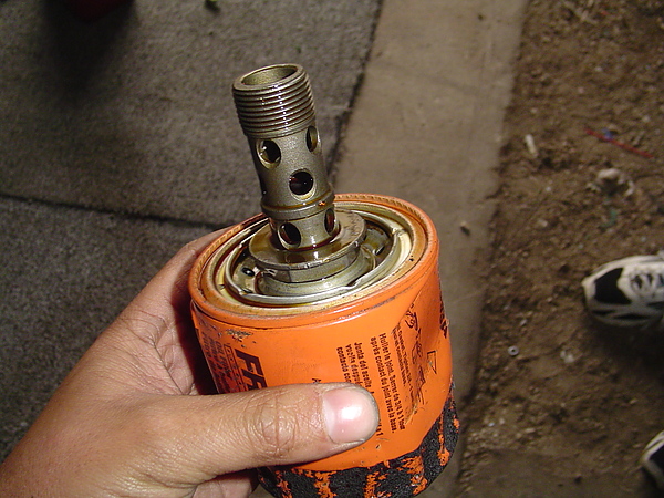

Here's a pic. It's not my picture though. Just found it off some website to show what I meant when I took off the filter. Thread got stuck to the filter. Managed to get the filter off and reinstall the thread.

As a mechanic ive encountered my share of super tight filters but never like that lol, glad to hear u fixed it though

Was this oil change done by a shop/lube place?
Take the filter and the part that came off and tell them to fix it.
Were the threads cross threaded?
Thats messed up
Man, that's bad news. Were you able to tell if the filter was cross-threaded, i.e. did the new filter screw on easily? Must have or you'd have said something, I'm sure. Sounds to me like the old one was seized on...wonder how long it was on there? You might also look into whether the 'thread' should have some threadlock on it when reinstalled to prevent this from happening again.

Yea, it was a pain. I managed to get the filter off the thread bolt by using a table clamp to hold it tight enough but not to dent it. Then, I just used some oil filter wrench to get it off. After that, I assumed that it was ok to put the thread bolt back on.
