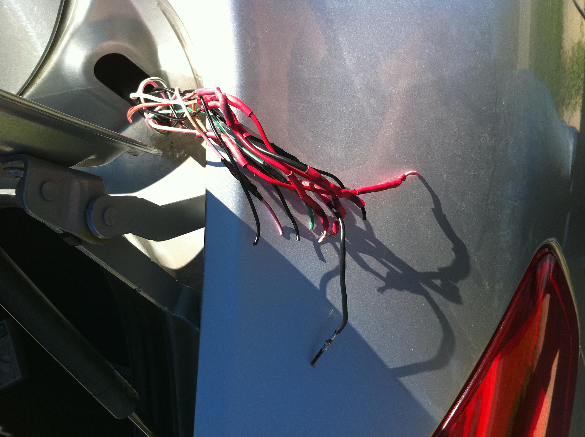

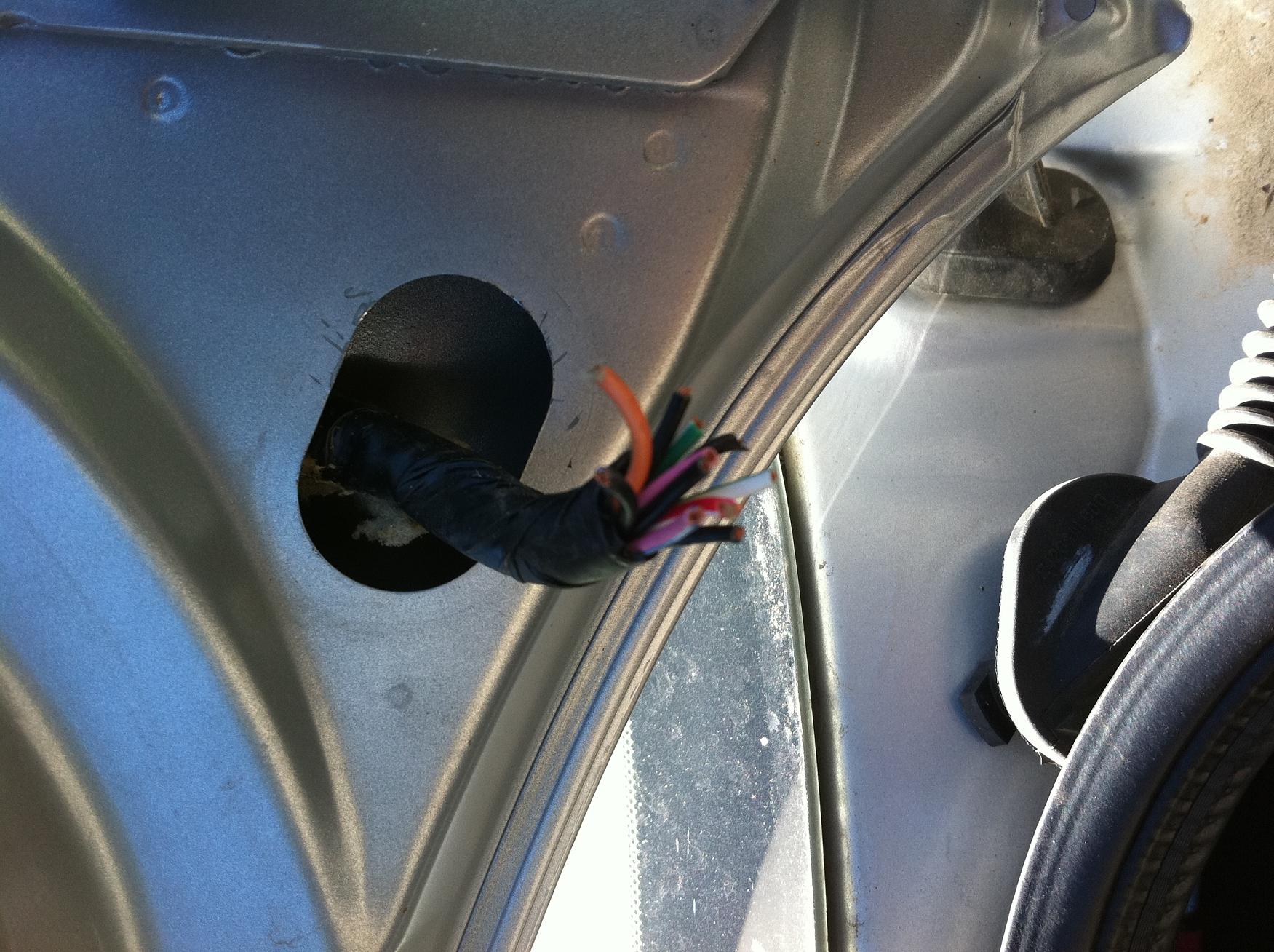

Well i figured out the problem and im not too happy! I got no reverse lights either! . It looks as if its been repaired before once or twice. just one more project I guess!

Ouch, that sucks. Sorry to see you found that mess.

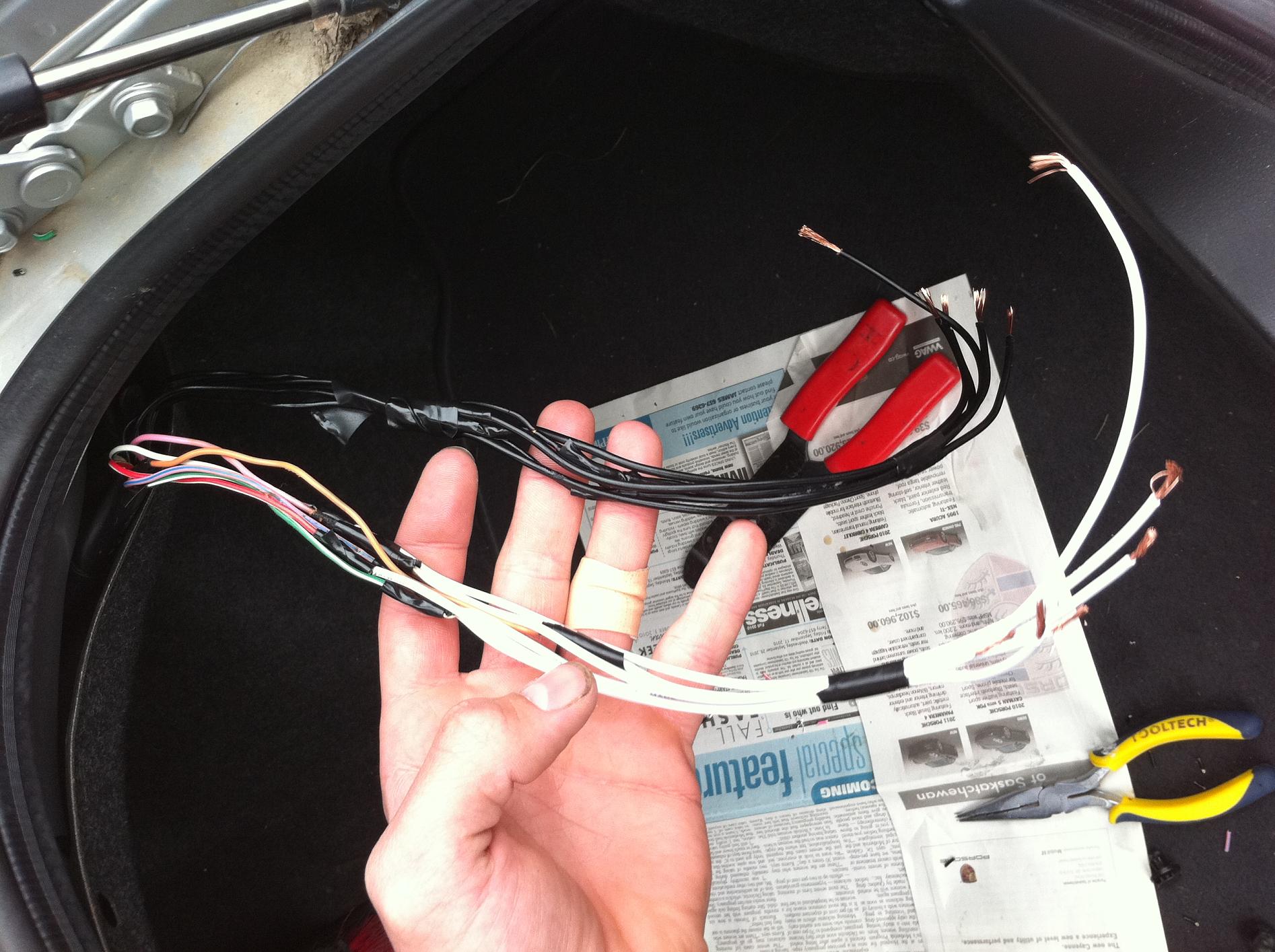

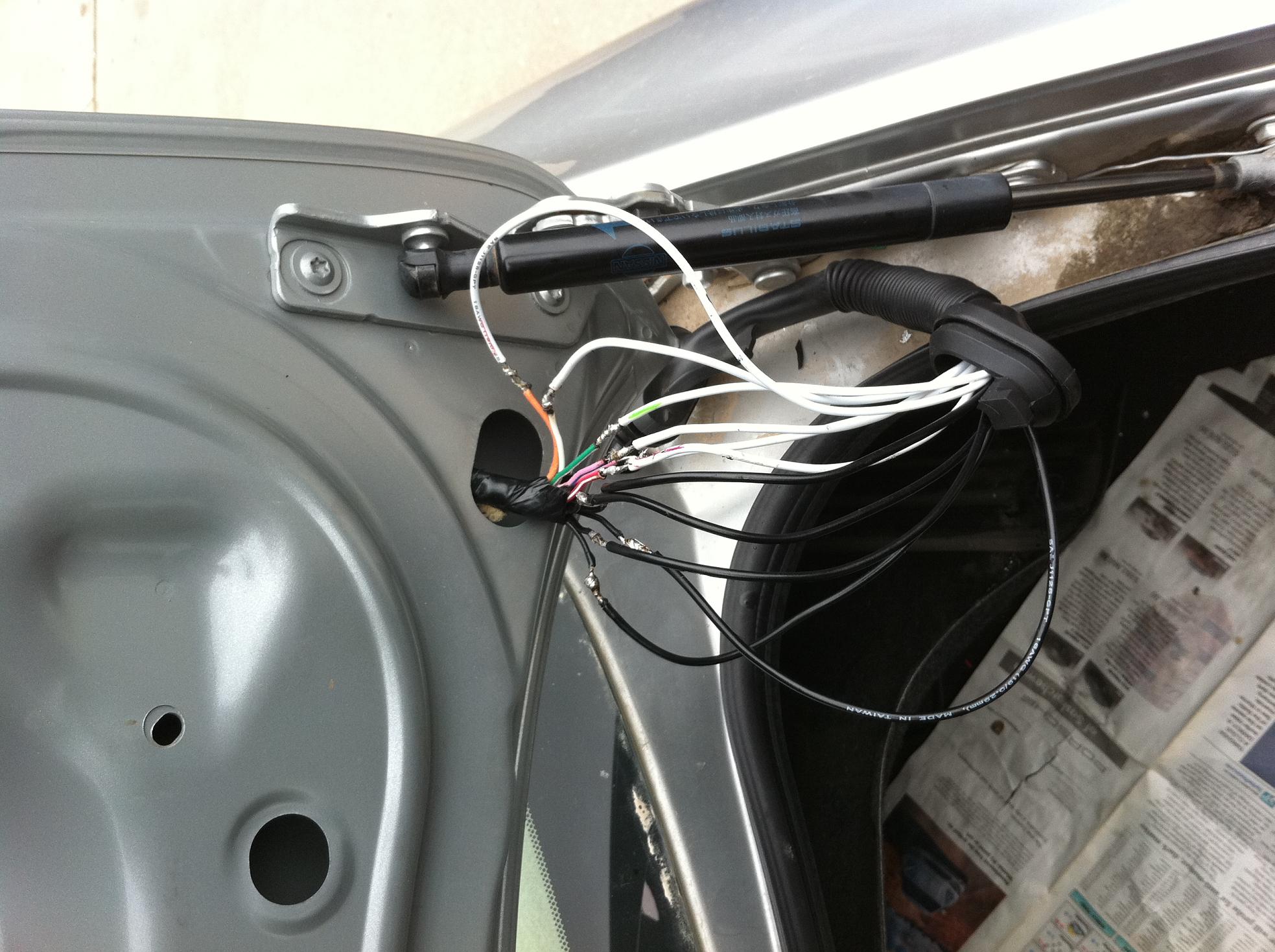

Had to learn how to solder over the weekend and i fixed the trunk and lights. works great!
