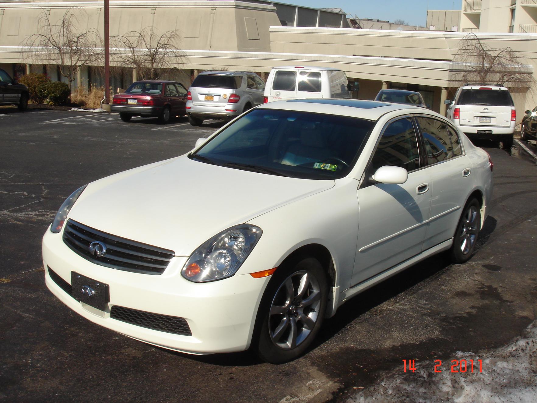

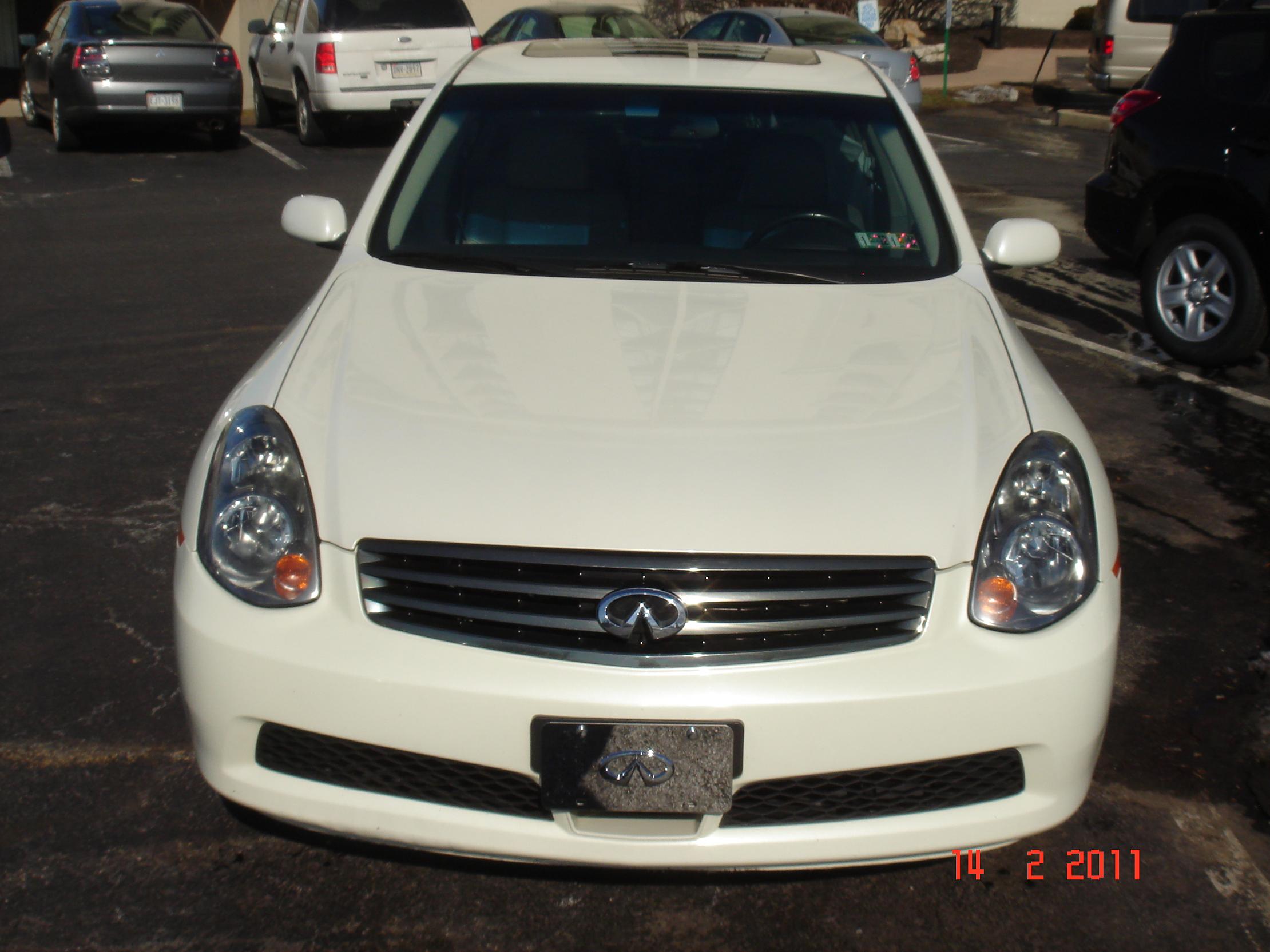

Old Feb 14, 2011 | 01:36 PM
cmex's Avatar
Joined: Feb 2011
Posts: 117
Thanks for the help!!!
i'll attach some photos

We got our 05 x's within days of each other! And your white one is gorgeous looking I must say. Mine is DG. Looks cleaner in the slush!
