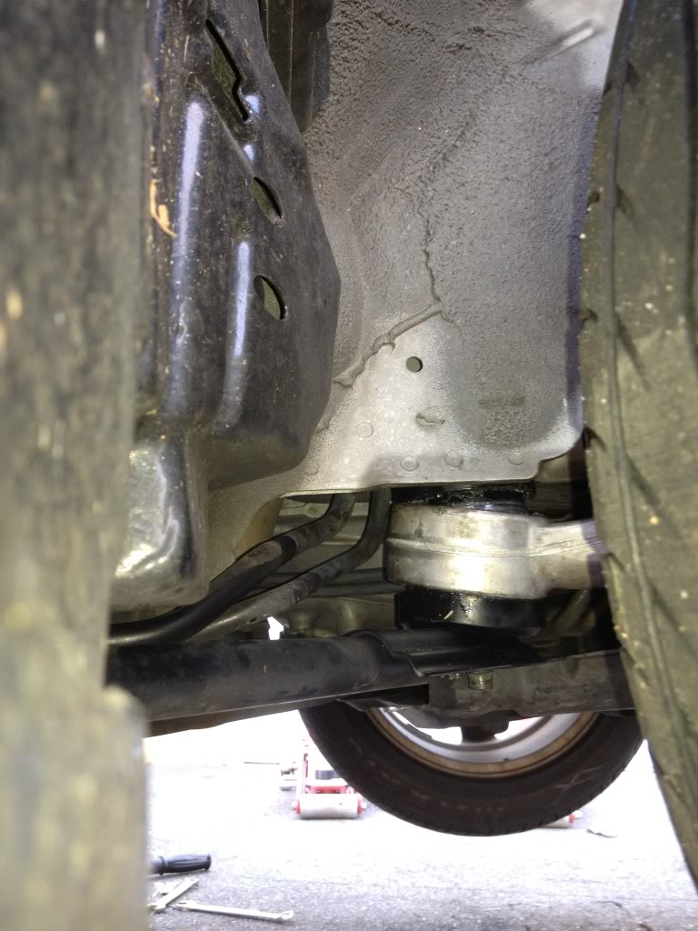

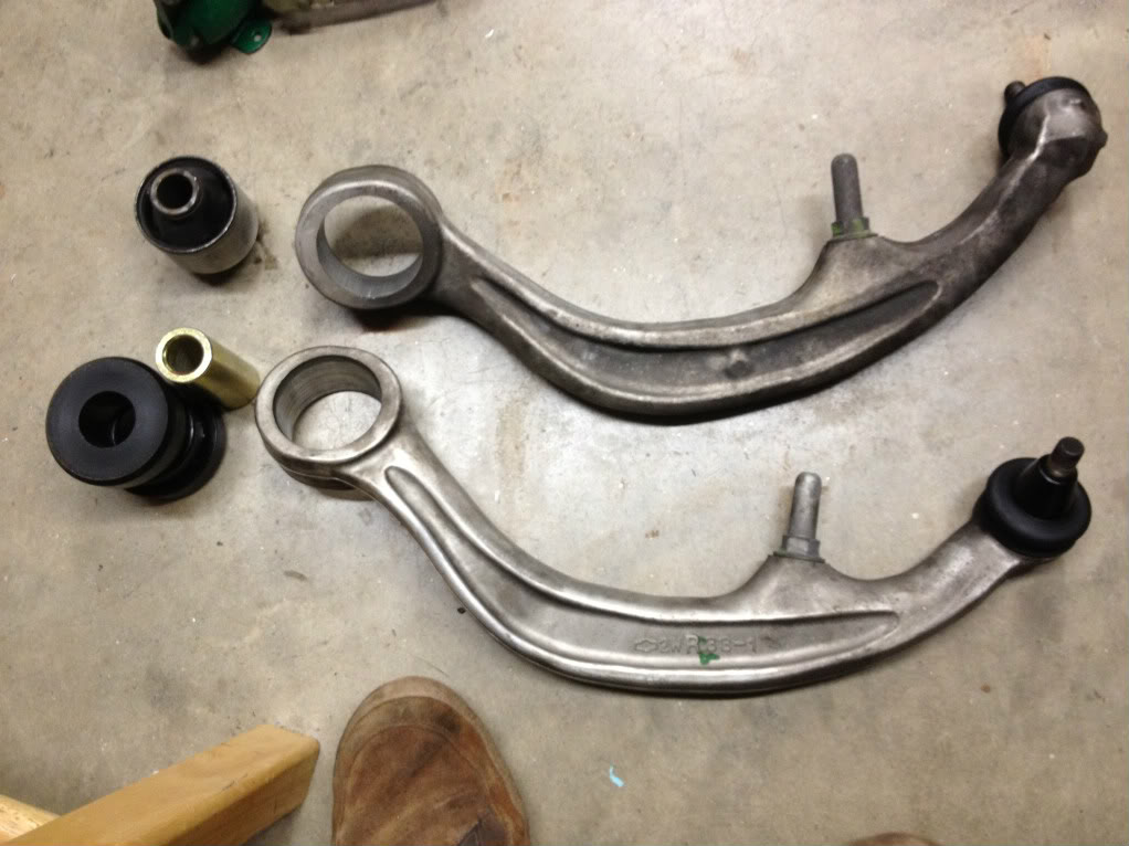

Problem solved...
Bushing install went smoothly. Used Energy Suspension bushings. Didn't fix the problem 100% but it did help. Ended up installing some Stillen rotors off of my buddy's 350z and new pads. Problem solved. It was a combination of warped rotor and blown out bushing causing my problem. Now if I can only get my hood to stop shaking when driving on the interstate.
