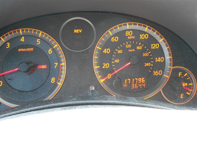

Reached milestone 17 today
Telcoman
It is tough to say goodby.

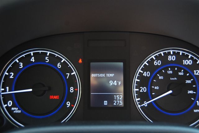

But nice to say hello
2012 G37 6 speed manual

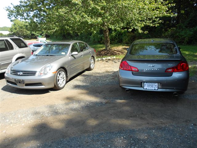

The final kiss goodby
124 miles
