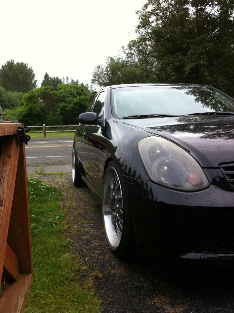

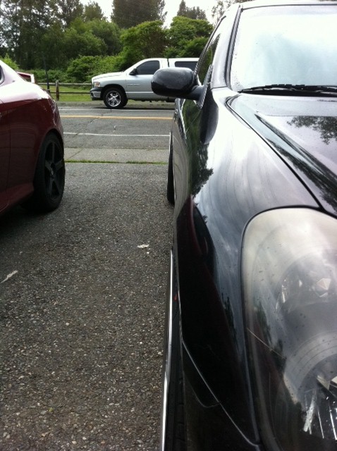

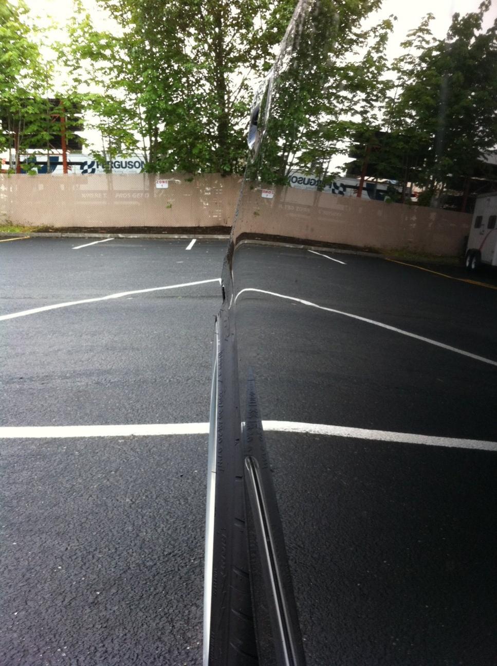

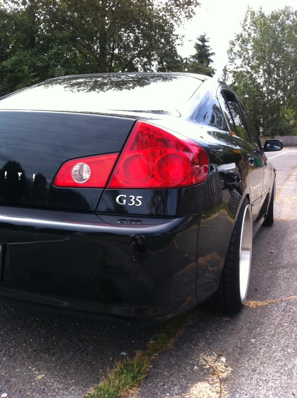

Wheels-photofs2.jpgHere are a few from my phone.
