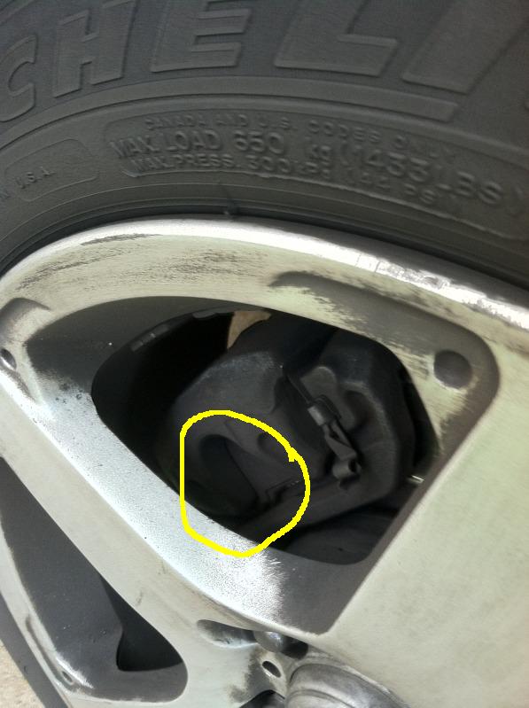

But when I took a look at her front calipers this is what i saw:
This looks like a single piston caliper to me. Am i missing something?

Understand each corner is a single caliper. i have always seen single pistons have that single "c" shape and dual pistons have that double "c" shape on the caliper

Your friend is mistaken, she has a 03-04, not 05-06, it shows in the picture that she has 17" 5-spoke sports wheel with lots of brake dust, which is a feature of OEM 03-04 brake pads. I'm surprised no one caught that.
So 03-04 = single piston with 11.7" rotor
Ding ding ding
He is correct

I am not trying to beat a dead horse here. But they look "physically" different. Look at the portion that I circled in yellow and compare between the two pictures. I assume that my friend knows what year her car is - hence why i am confused.
Unless nissan/infiniti made two types of dual piston calipers.
Yes they are 5-spoke wheels and yes there is a boat load of brake dust. the front passenger side was even worse.
I am going to crawl under and look at the backside of the caliper and measure the rotor to confirm when i see her again in order to confirm. I made the thread thinking there was some other explanation.
I was just going to say that.
That rim is not an 2006 rim, it's a 2003-2004 rim.
Please confirm the year of the car she has. Just check the door sticker or snap a pic of the exterior.
Save the effort....check the door sticker and check the date of manufacturer. Snap a pic of the car.
Seems like she has a 2003-2004, and not a 2006.

Just open the door and see when the car was manufactured, unfortunately most(not all) women do not know what they are talking about when it comes to cars. this is pretty much why I asked again.
You need to confirm the year.
