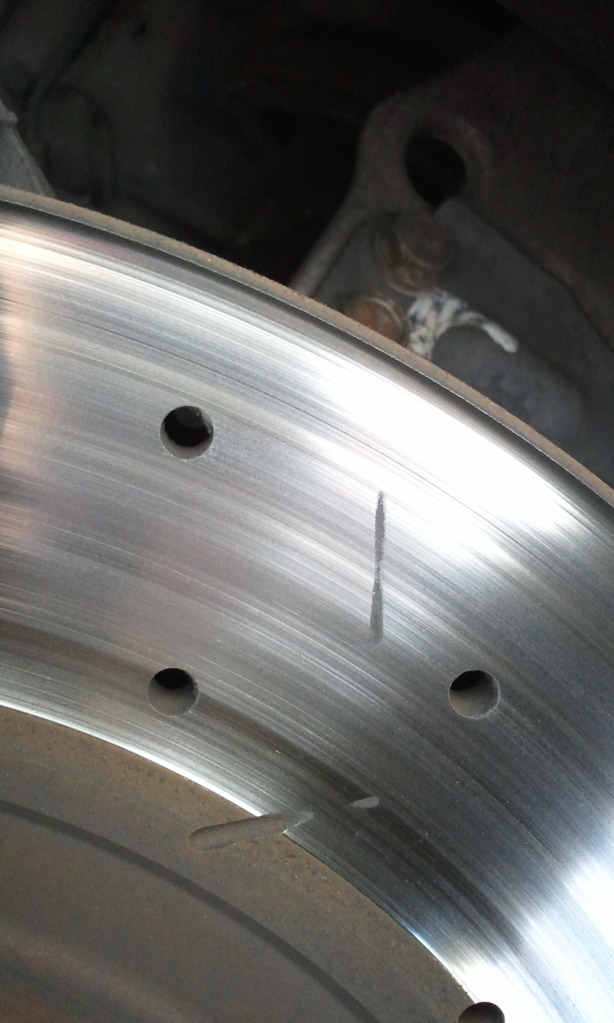

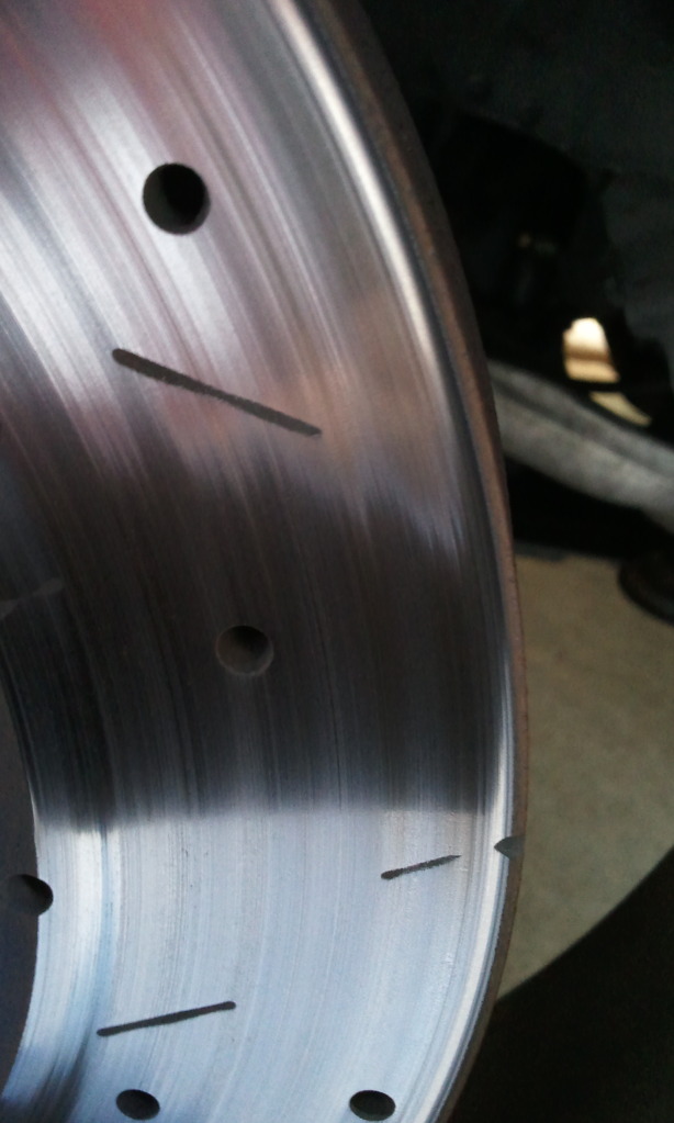

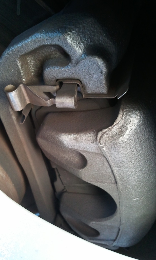

03 sedan with ~185K. Current rotors/calipers are aftermarket and were installed a long while back. Rotors were turned about 15-20K miles ago...just got new tires and was told the rotors were in pretty awful need of replacement. After I took a closer look, I'm in agreement ...there is a pretty nasty lip.
My question is this...does the fact that the calipers are aftermarket affect what rotors I get now? I unfortunately have no idea what brand the current caliper/rotors are, and really have no idea how to check.

What indication do you have that your calipers are aftermarket? Those are looking very stock to me. The clip/retaining hardware in your last picture is definitely stock.
Your rotors are obviously not stock, so I would just replace those with any common rotor for your car model. Avoid the cross-drilled and slotted scene (which is what you have now) unless you're doing autocrossing or some other enthusiast events. Even then, with stock calipers, I would just stick with normal rotors. If you're doing it yourself, you can get centric (who is the oem for a ton of other companies) rotors on amazon (free shipping, which is great for heavy rotors) or your favorite car parts store will have several options.

Yeah was just watching a video, and I agree that the calipers do indeed look stock. I'm not too educated when it comes to this sort of stuff...but the only difference I can tell is the stock caliper from the video had what appeared to be a "15" labeled on it, and mine has what appears to be an "18".
