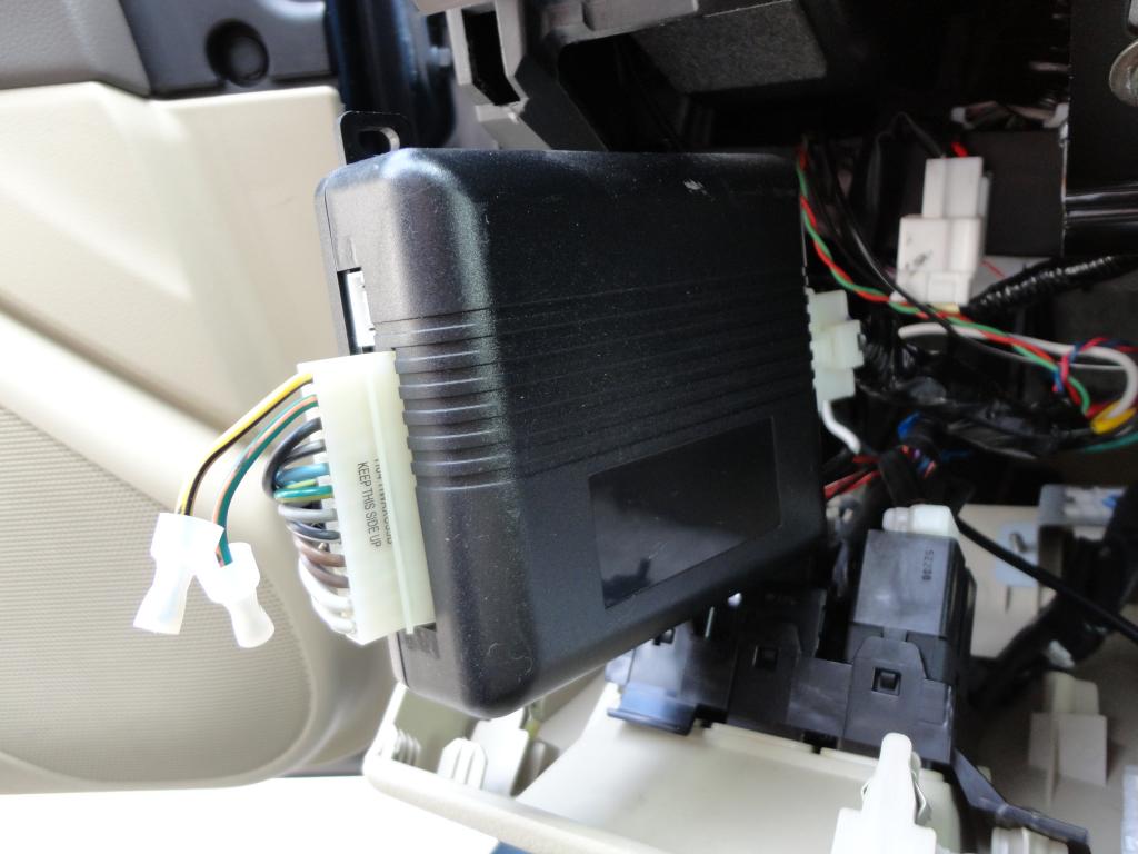

Mystery solved. Curiosity got the best of me. Sure enough it's aftermarket:
Now just trying to figure out who the manufacturer is since there are no markings on it - just a model number...
EDIT: Just searched the part number...it's an AudioVox "prestige platinum plus"...ugh. Oh well, it seems to work.
