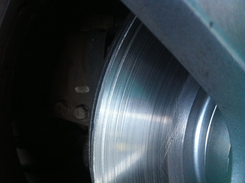

I just changed my front brake pads to OEM and front rotors to autozone because I felt vibration while braking on highway and pulsation while brake at slow speed. After brake jobs done, it got better but still there. Tried to hit the foot brake only then there was NO pulsation, did't try it on highway it's dangerous. I assume it would not be the rear brake? Or it would be my caliper? I noticed the rotors are worn differently from others. Picture is attached. I'm running out of idea what causes this. Any idea? Thanks.

Lovely, it looks like you have uneven wear on your rotor. My guess is you have a bad caliper, it may not be "floating" like it should (could be frozen or stuck) which would cause the brake pads to wear funny. A good way to check for this issue is to inspect the rotor after driving the car and testing it's temp. If it's significantly hotter than the other rotors that's your problem.

I had the same problem even after changing my rear calipers and pads. Ended up being worn out wheel bearings that were causing the loud vibration when braking.

I checked my rotors, had them turned a little, replaced the pads, and still had a little shake at 55mph-75mph braking. A week later, I started getting a horrible groan/grind noise from the front wheels. Replaced wheel bearings, problem solved.

Brakes on the early sedans are horrible. Rotors are known to warp badly and calipers are known to seize.
I had the same problems you are having. All of this was solved when I upgraded to the 2005+ OEM coupe brakes. They have bigger calipers and bigger rotors than what our 2003-2004 sedans have.
I would suggest replacing the one problematic caliper.

I have an 06 and it still has the same issues described above. Lack of regualr brake fluid flush cause brake components to rust from the inside causing seizing pins / pistons etc.
Timely fluid flushes are key. I bought the car used so im gonna put the blame on the previous owners (ive already done a brake flush but most of the damage was done prior to that i think)
