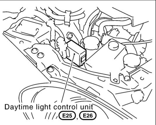

I noted a clicking sound from this box at the front passenger side of the engine bay when the engine is running. When I attempt to turn on the lowbeams I get a buzzing sound from the same box. It has 2 harnesses connected to it and I disconnected it and ran the car but then turn on the turn signal would cause a rough idle and RPM drop.
What is this box?
What is this box?
I think that's your Daytime Running Light control unit for Canada (see below) although I don't think the white zip-tie was part of the stock installation... Glad the IPDM looks OK. Beyond that I've got no idea what could be causing your cascading errors, you should probably take it somewhere and have the codes read to help diagnose it. Other members here may have better ideas. Do you think your aftermarket audio system or remote start mods might be messing with things? Ground kit all intact?
