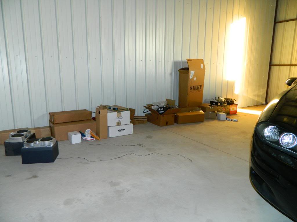

heres everything to do the swap

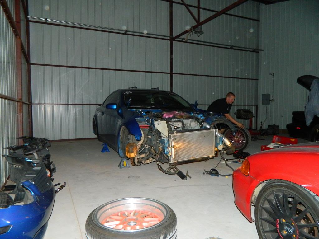

got started on friday once we got everything in the shop ignore the broke *** filter he hit a bag of dog food and messed some stuff up

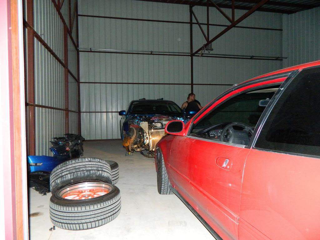

since we dont have electric ran yet in the shop we gotta wait till monday to run lights radio ext.. so this will have to do till then for a radio

ignore how bright the flash is lol its pitch black in there so we wanted to get stuff done and we pulled the hatch in and used it for light since they were changing brakes and rotors on there anyway

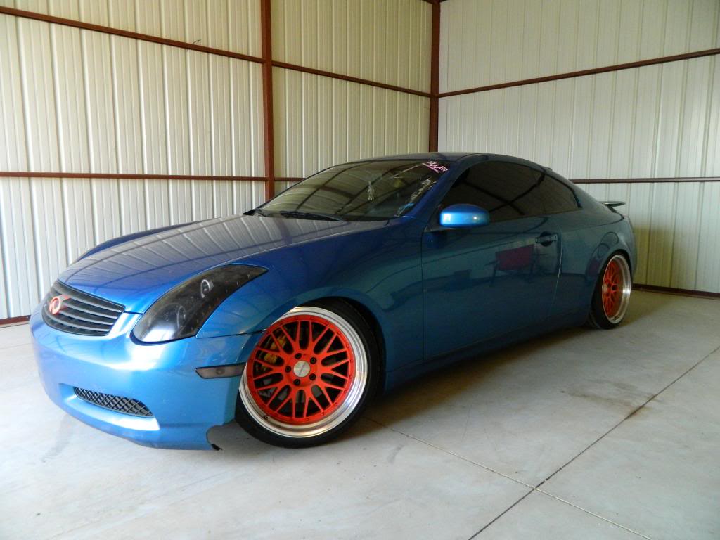

theyre taking rims off since he will have a drag setup on there low and slow just turned to gofastparts =)

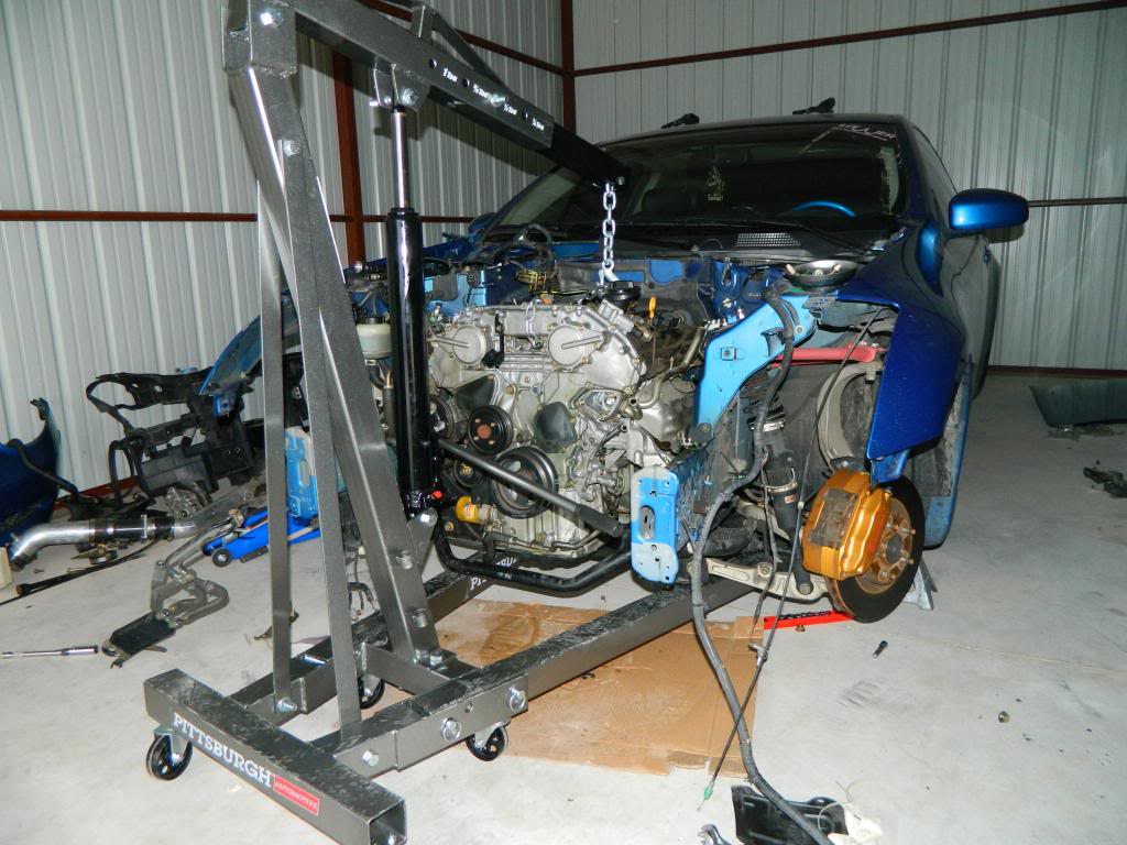

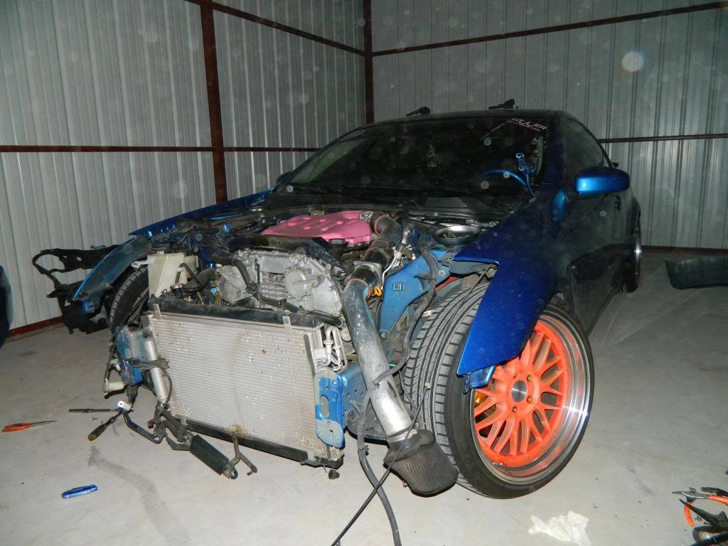

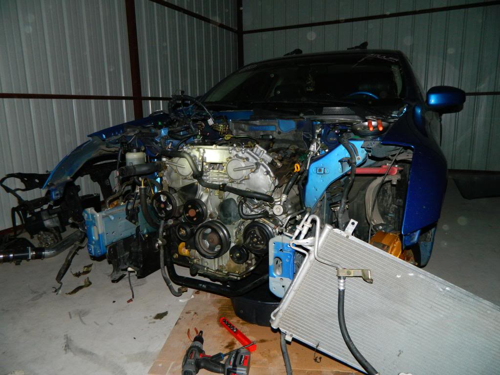

got the plenum off and radiator along with belts and a few hoses didnt have the tool for condensor yet

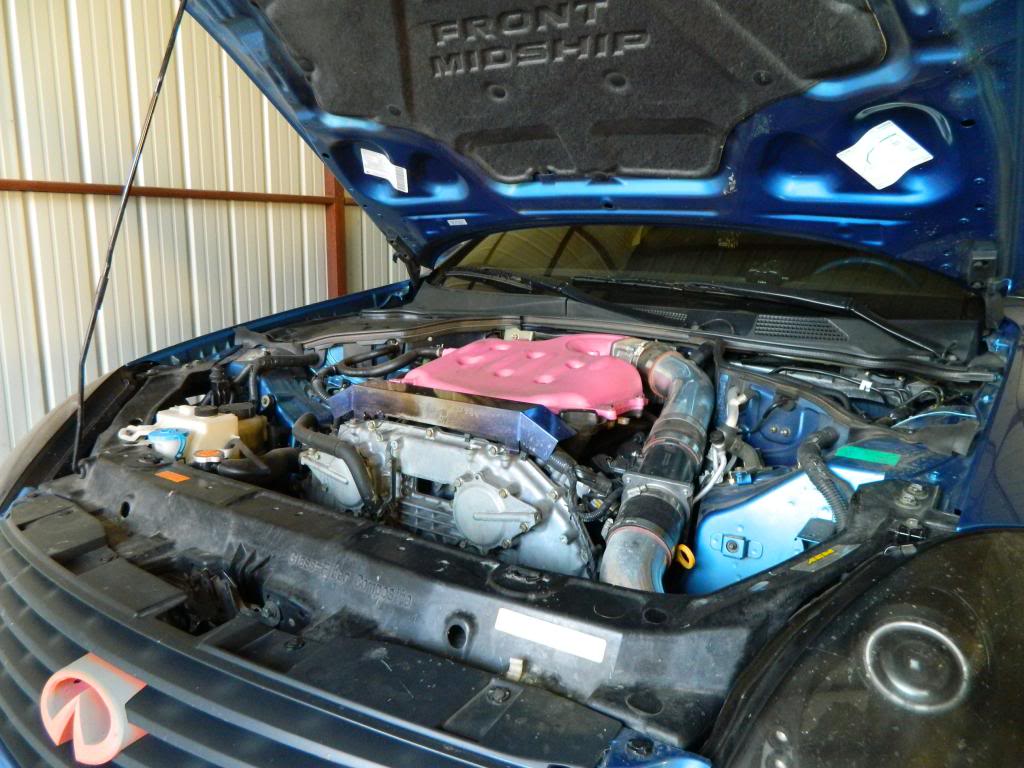

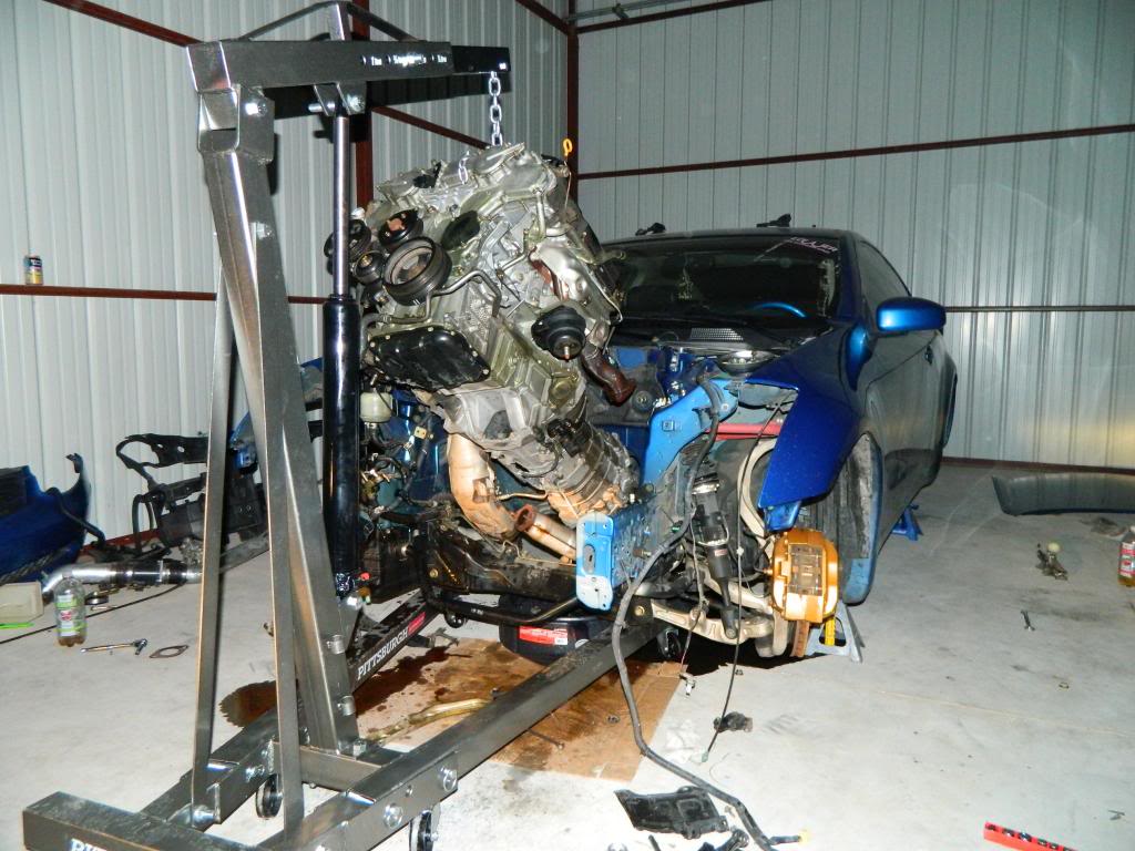

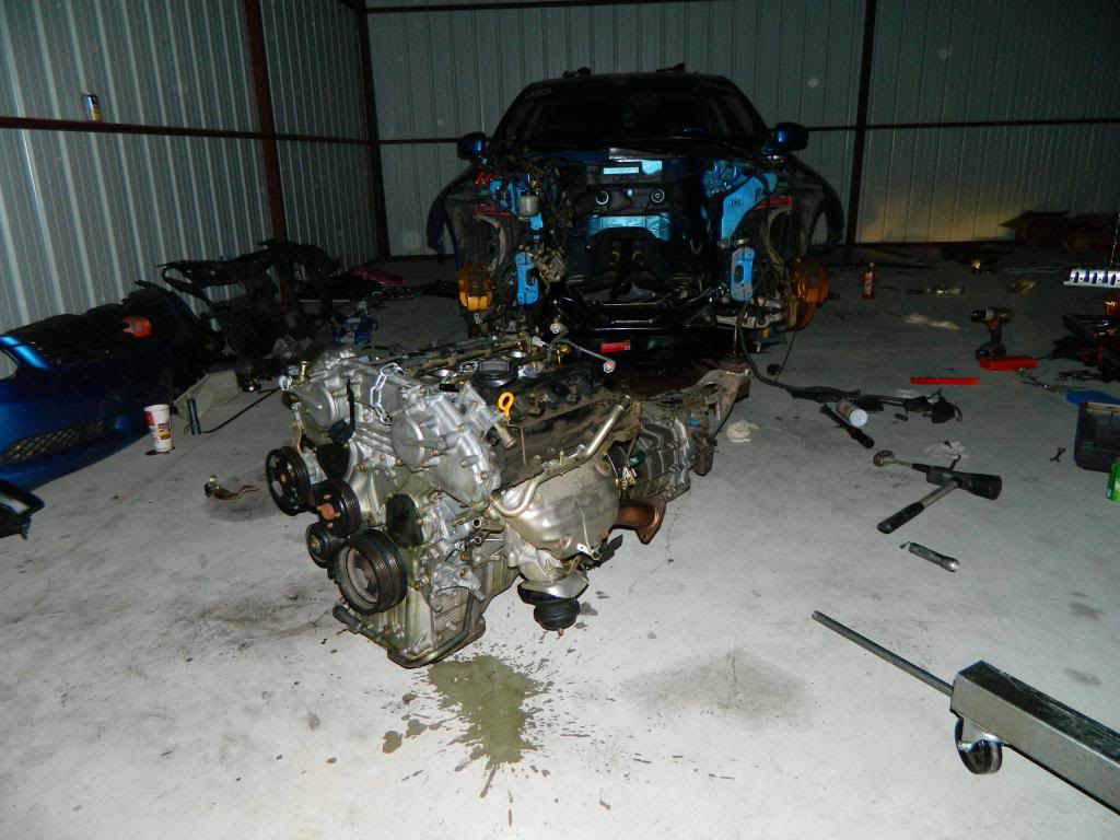

do fresh day and we removed alternator and ac compressor and condensor found out its a bitch to get the motor mounts off the motor with the header attached and saw its much easier to unbolt from underneath to just pull em completely with motor

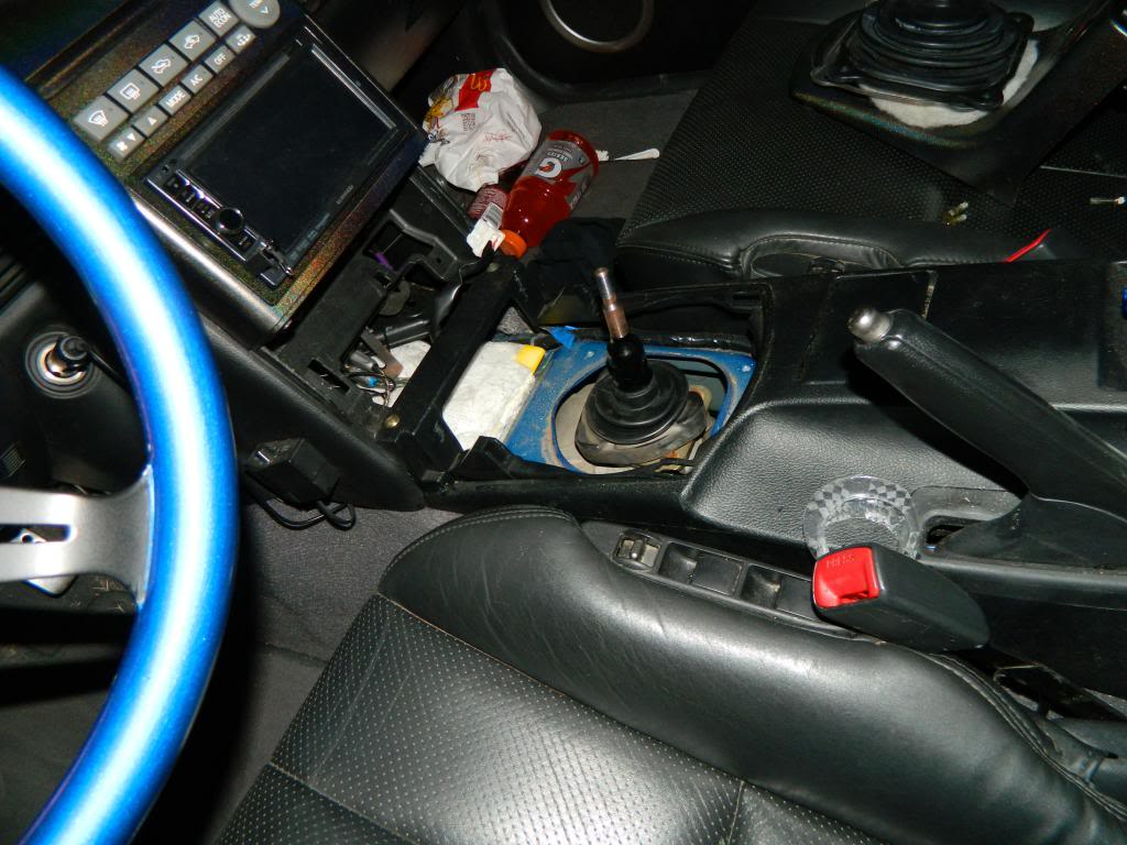

unbolted shifter driveshaft and transmount

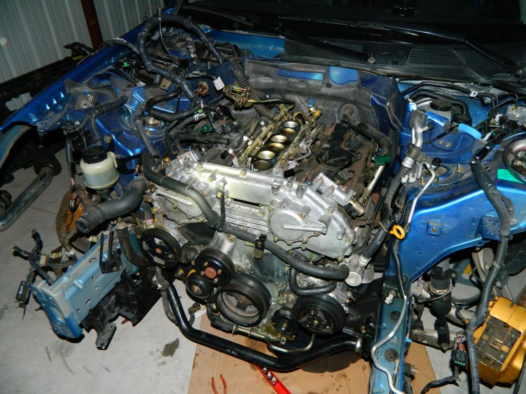

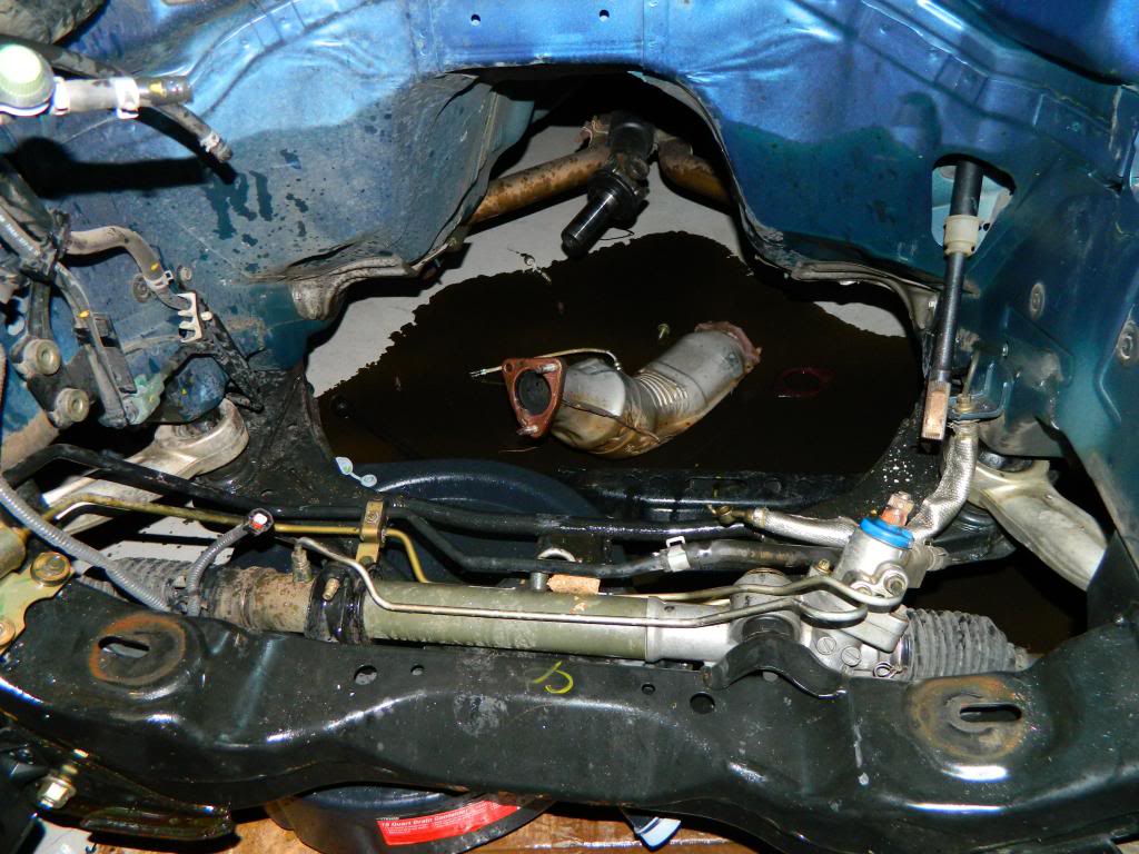

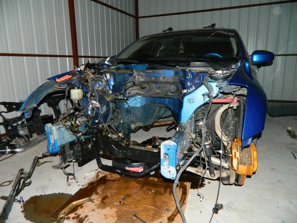

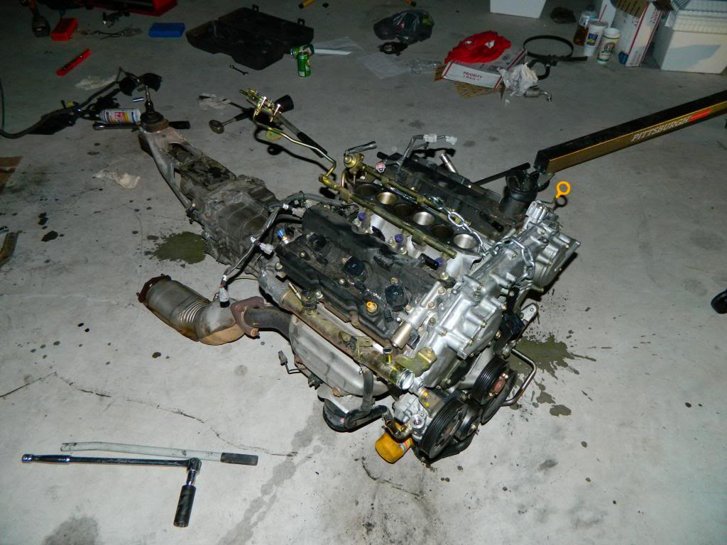

after yanking and pulling we finally got the damn thing free finding a few bumps in the road like the catalytic converters catching on steering so unbolted driver side thank god for pb blaster it was rusted beyond beleive and a bolt snapped so did alot of cussing and hammering to get it off
got her out after unplugging more of the harness finding it wrapped all under the trans and under the motor man are there a bunch of metal brackets on there god knows how much weight hes saving just from them and heatsheilds!

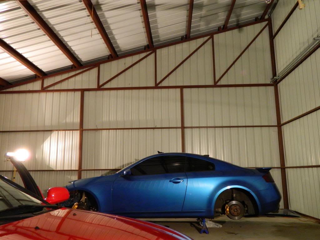

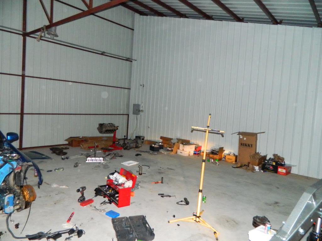

so on this rainy day we werent rushing anything just doing little stuff here and there until this weekend when we pull the all nighter and get er done !

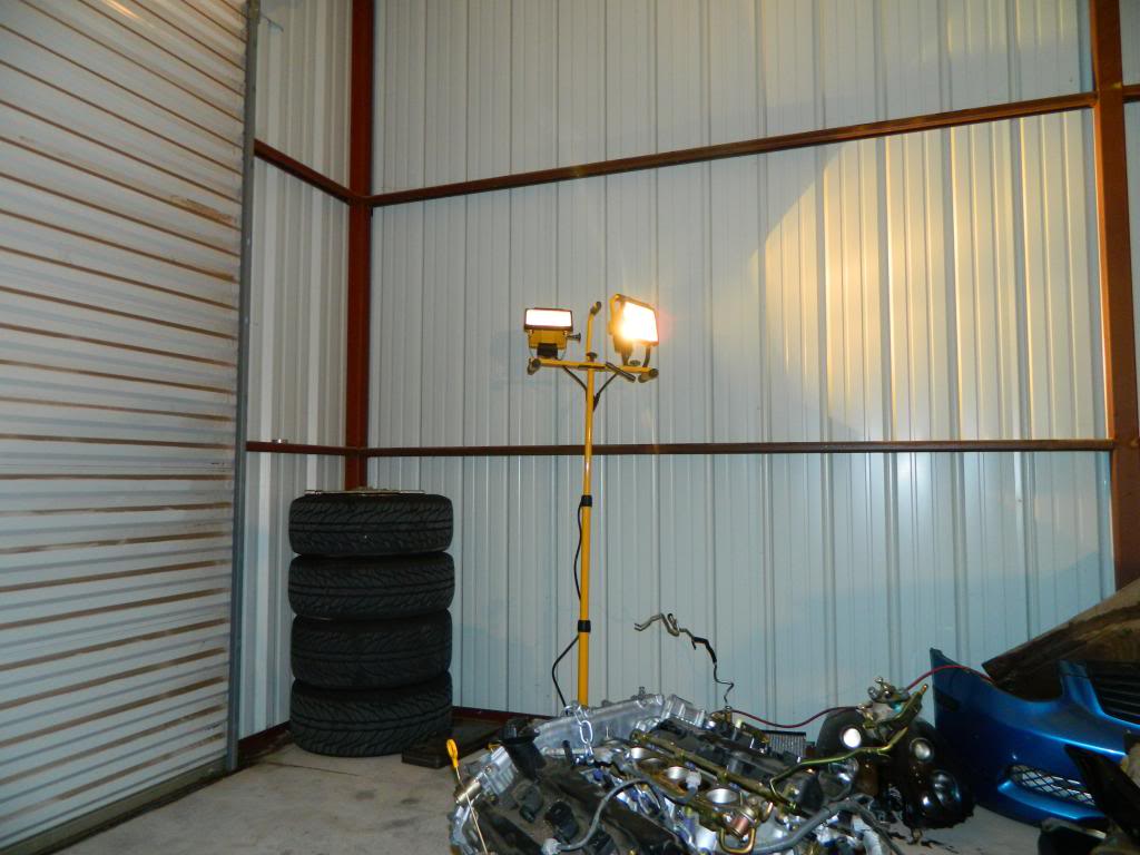

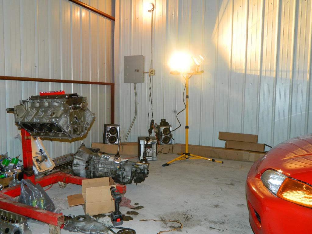

finally got electricity and got some overhead shop lights they werent bright at all so we got 2 of these stand up lights for 30$ and the whole shop is lit up now got our radio and everything. but did find out that water gets in so we had to move everything to back wall throwing away boxes we dont need
with no flash you can tell how bright it is in here so we dont have to use the hatch and a bunch of flashlights again

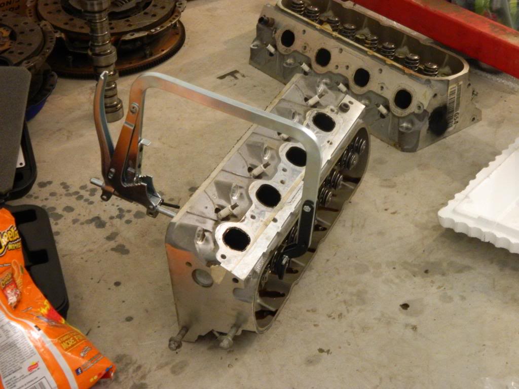

went ahead and removed the springs with a handy tool from advanced auto its a life saver! getting em ready to clean.

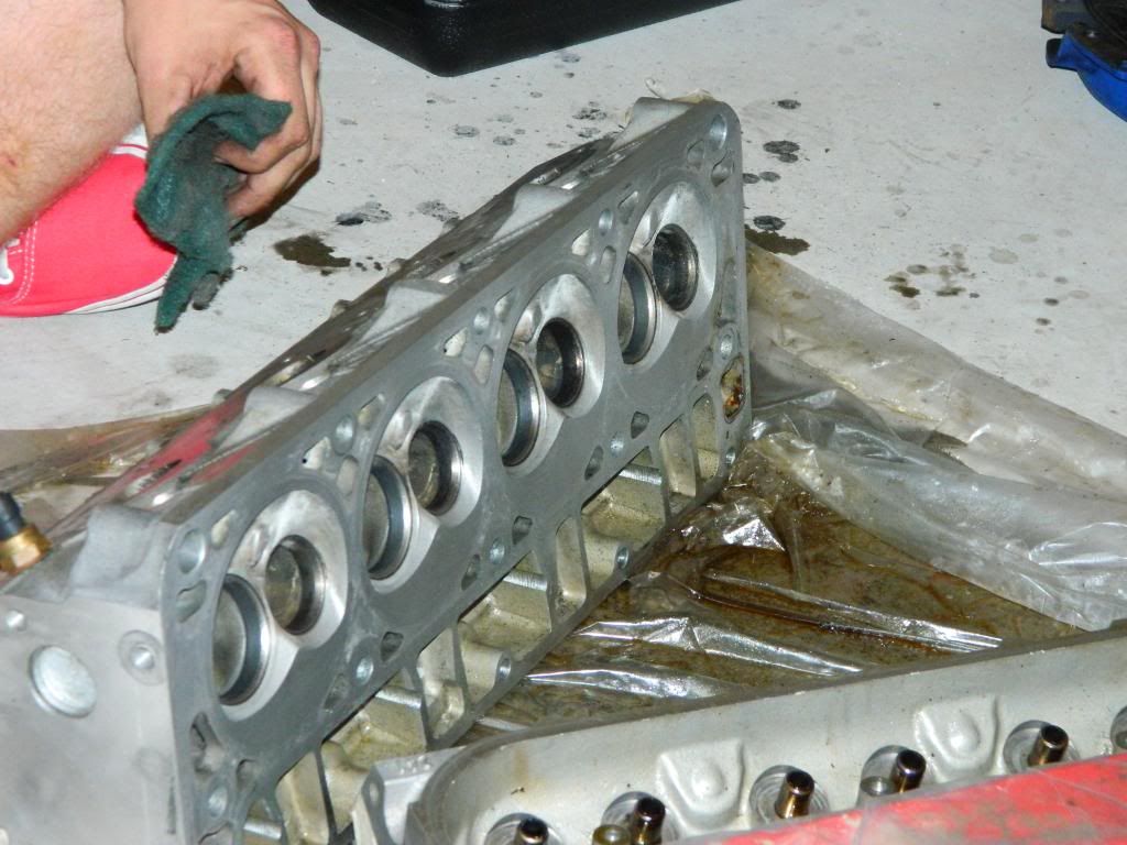

got springs off the heads and seals now theyre ready for some carb cleaner and scotchbrite dont want dirty heads on a clean motor

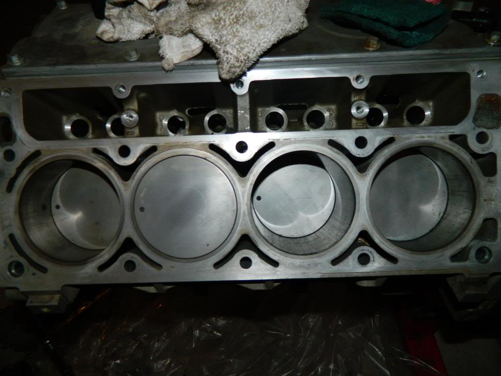

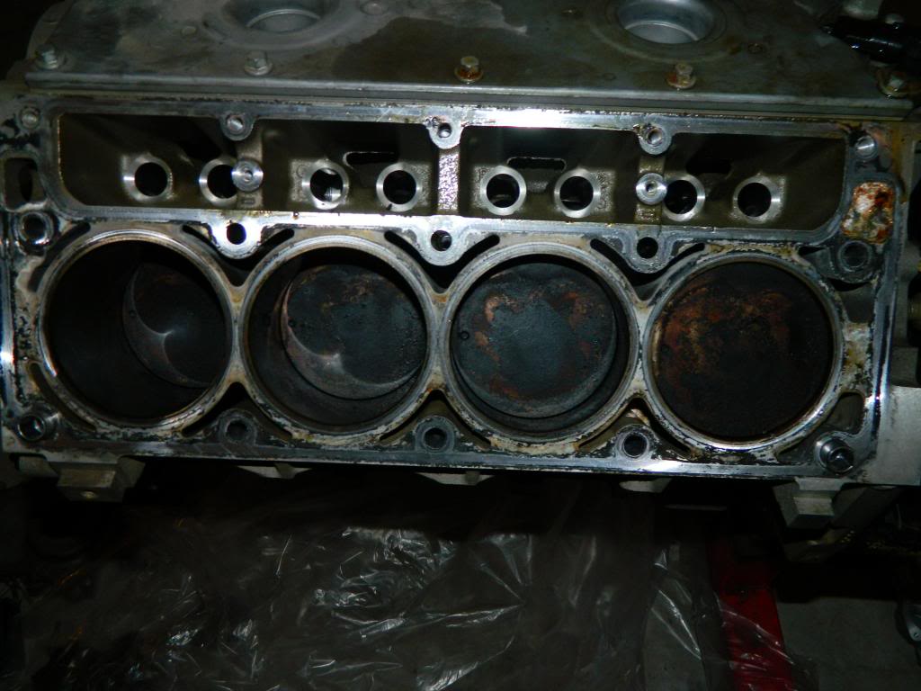

meanwhile while kyle was cleaning the heads i decided to start cleaning up the only thing dirty on the motor the nasty pistons heres a before and after with a ton of elbow grease and carb cleaner

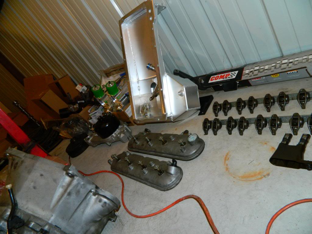

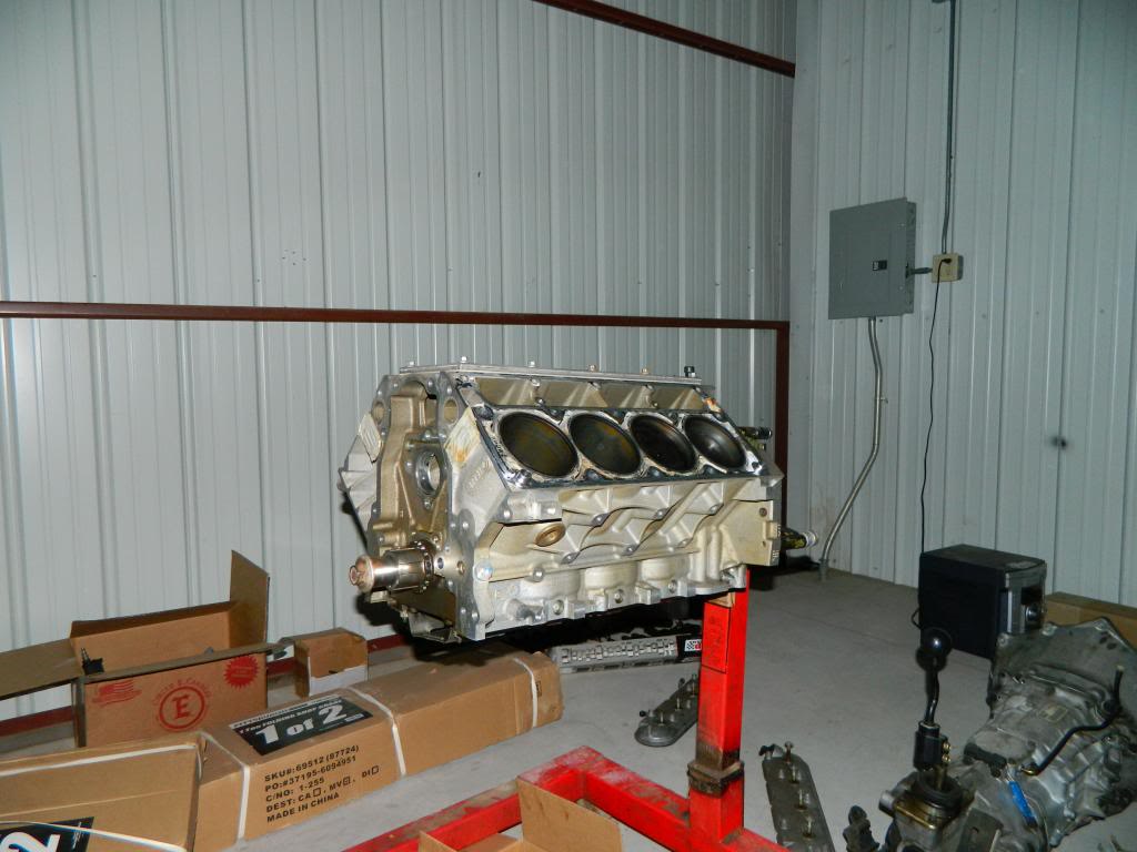

heres a pic of some parts we went through
