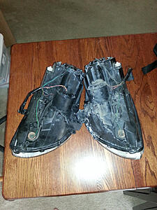

Do some G35 sedans not come with HID's?
I bought these a while ago and dont need them anymore but I see that there was no ballast with these and that there is only a single connector for the headlights. The top bulb does not work....what do I need to do to convert the top bulb to HID?

Wow I wasn't aware of that. Is there an easy fix for this? I'd assume you have to rewire the light to connect a ballast and HID bulb.

Technically, you need an entire headlight housing from an 03/04 with HID in addition to bulbs, ballasts, etc.
Reflector housings for HID are different than reflector housings for halogen. The focal point where the light eminates from the bulb is in different spots for each lighting style. So that requires a slightly different shape to the reflector to avoid glare.
IMHO, Early G35's with HID low-beam retrofits are some of the worst glaring car's i've seen on the road.
