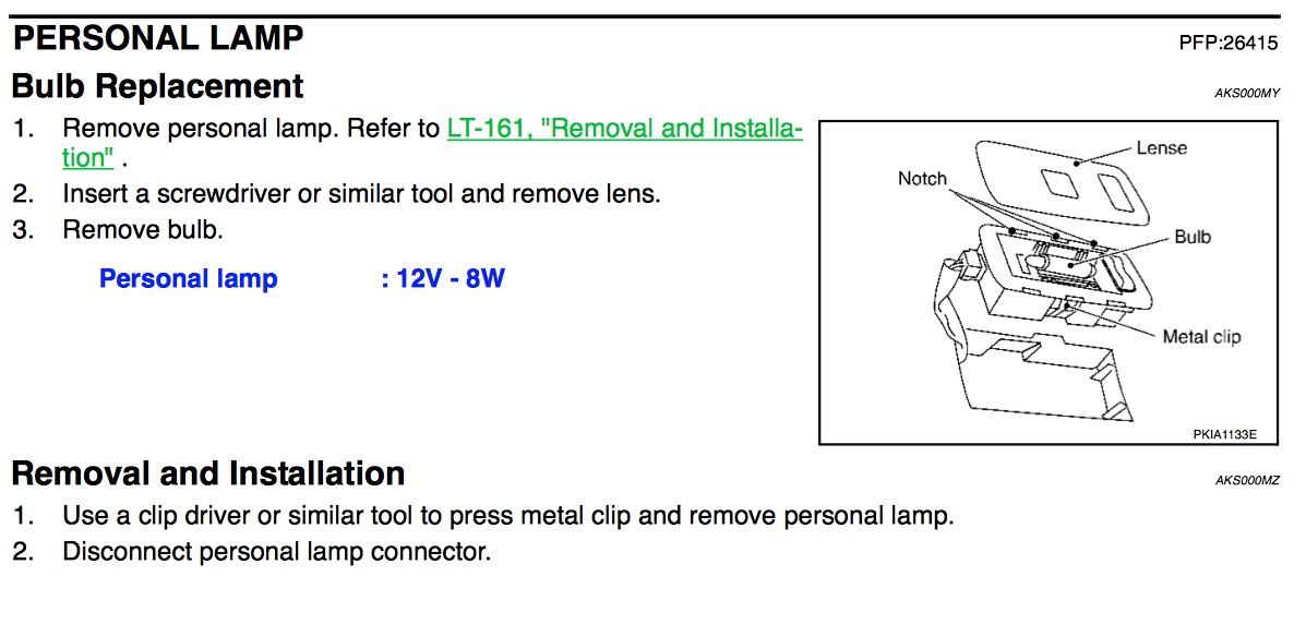

A couple thoughts:
First, below is a pic of the rear "personal lamps". Hope that helps with that.
The other thing is (and others here can help with this) I think LEDs generally operate at lower voltage than regular 12v bulbs and it is rare to see an LED that can fade out. They are either on or off generally. So, the circuit which fades out the main dome lights may not like the electrical "load" of the LEDs you're using. It could also be that there is normally some small voltage there even when the dome lights are off, not enough to light the 12v lamps but enough to light your LEDs... Kind of a long shot but it's an idea. What LEDs are you using?
That doesn't help explain your other odd issues though. I guess I would first try putting all the original bulbs back in to see if things go back to "normal"...

These are the LEDs I'm using. I really like them, the brightness is the same as stock and the cool white color is nice. I'm hoping I get to keep them.
I put the original bulbs back in and the issues still exist. Luckly though my next door neighbor is the manager/supervisor of a Nissan dealership and he said he would have his tech call me tomorrow.
Wow, I can't believe I didn't catch this, but as I was waiting 30 sec with the negative terminal unhooked I noticed that my passenger door was open... yeah...
The light wasn't on on the dash so I assumed that they were closed, but it was in that half closed position where it's still cracked even though it can lock and the light won't show.
So after I reconnected the battery everything was back to normal, and I finished installing the lights. I guess I'll update this post with pics so that this thread isn't too useless
