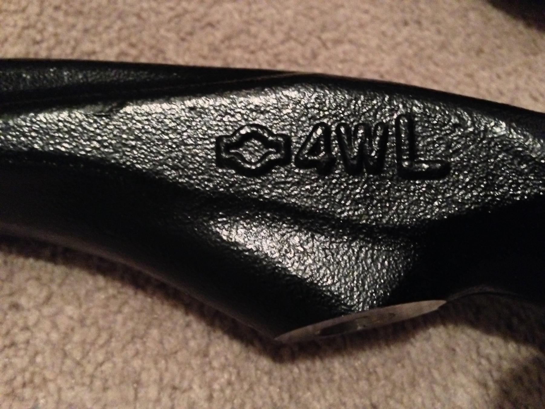

I just ordered left and right compression rods for my 2004 G35X and they came in today. Here is what they look like. Note that they also say '4W' on them. Also is a picture of the infiniti invoice showing the part numbers. I believe these are the same part numbers for the 2004, 2005, 2006 all-wheel-drive models.
Attached Thumbnails Compression rod aka lower rear control arm on 2004 g35x vs g35 vs coupe-img_0876.jpg   Compression rod aka lower rear control arm on 2004 g35x vs g35 vs coupe-img_0877.jpg   Compression rod aka lower rear control arm on 2004 g35x vs g35 vs coupe-img_0878.jpg

the RWD and the X compression rods are shaped differently. I have attempted to install a RWD CR on my X and no go. Simply will not fit as stated above.
