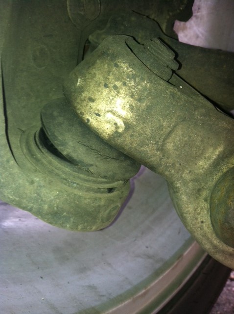

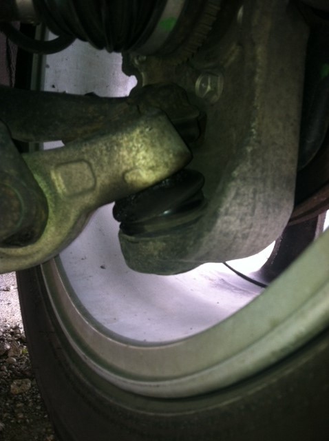

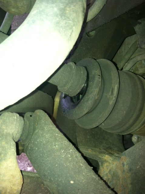

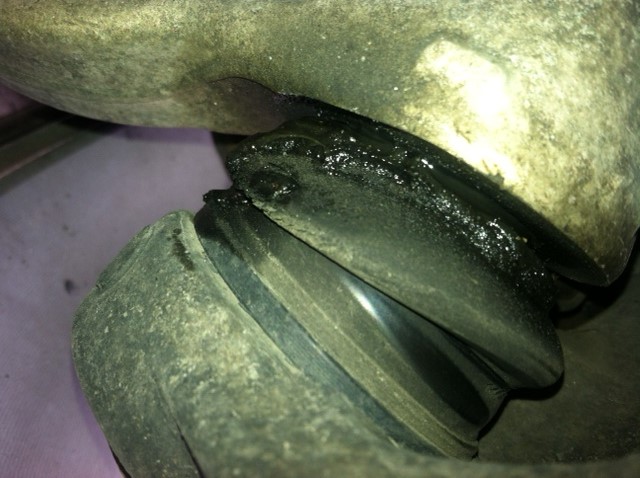

Had a chance to peak under the car a bit yesterday.
Looks like the Outer Transverse Link Bushings are shot.
I've also got a torn boot on the CV Halfshaft on the passenger side.

Old Apr 1, 2014 | 12:05 PM
Mustang5L5's Avatar
Posts: 8,818
Likes: 468
From: Taxachusetts
If you get to replace that boot soon, you might save the universal shaft and just have to reboot it.
As for those bushings, they are a bit of a pain. For one, they are an expensive bushing (~$70) and you need to remove the knuckle off the car for easy access to pressing them out and pressing the new ones in.
I'm sure it can be done in car, but removing the knuckle isn't that bad really.
