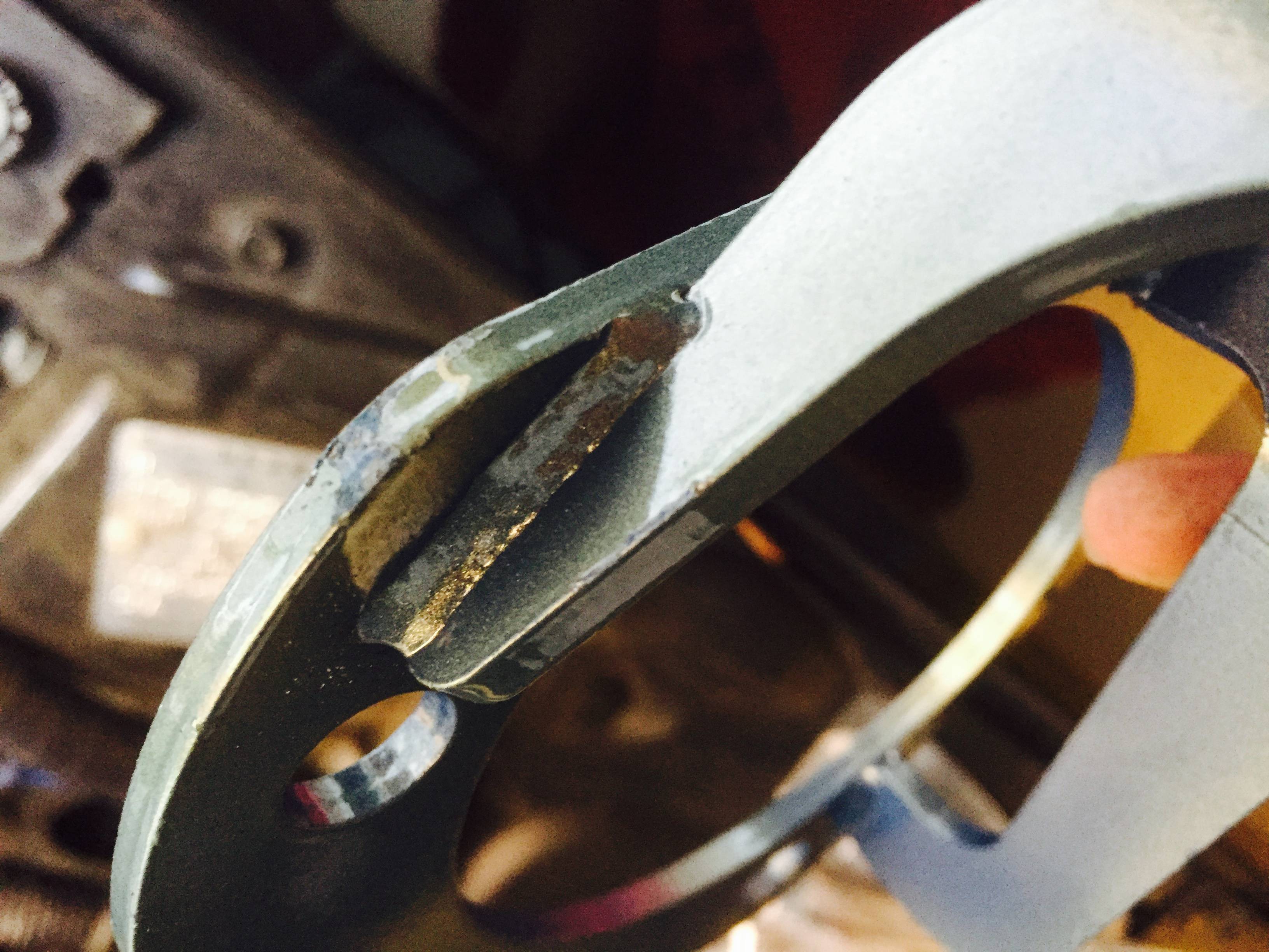

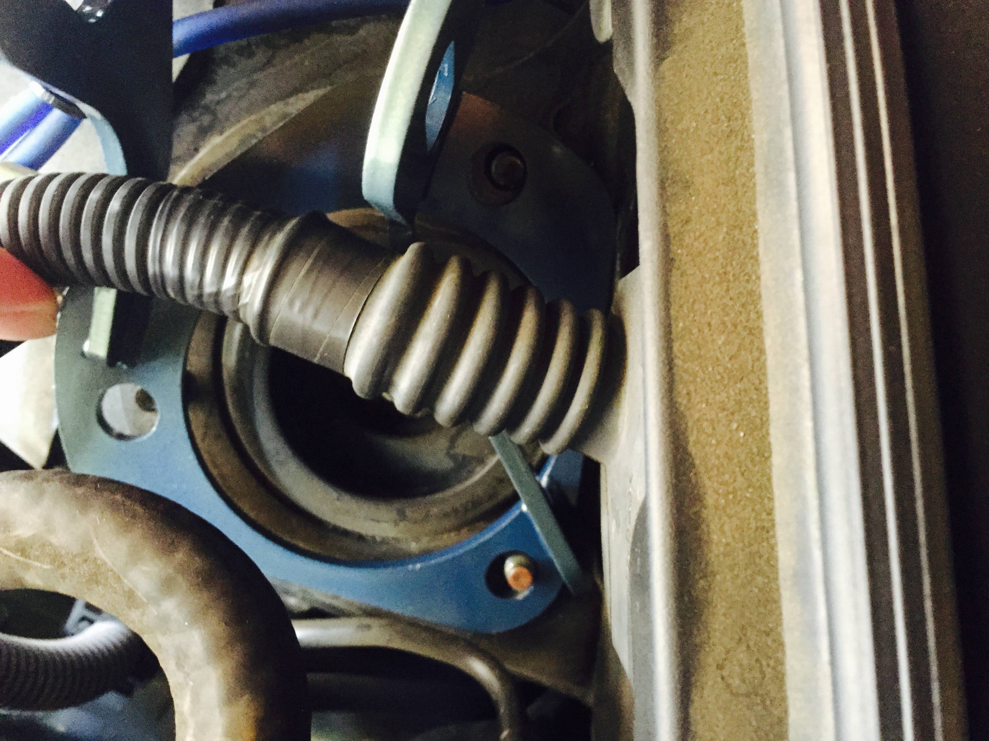

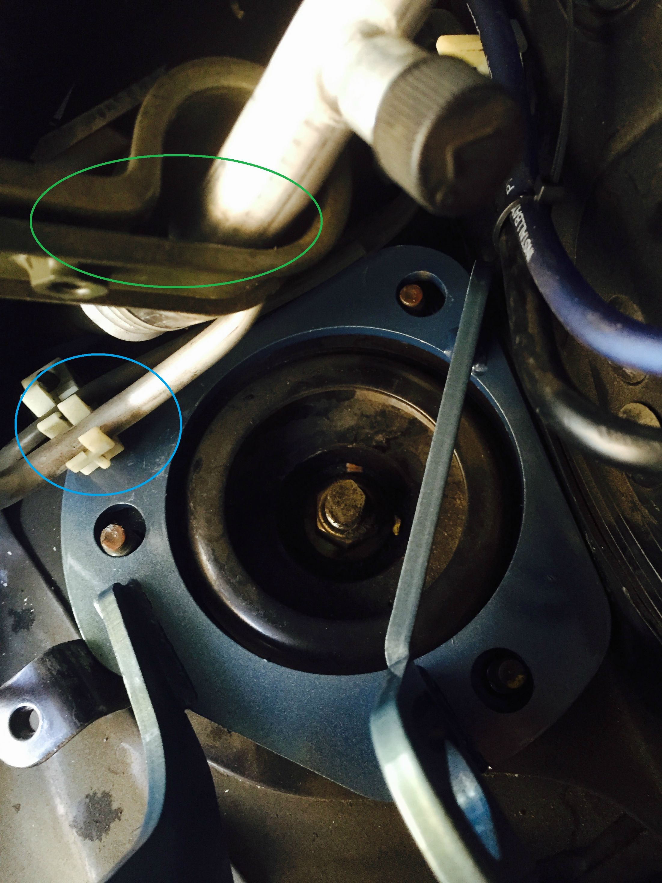

Driver's side:
Green circle is the bracket on the car I had to unscrew to be able to get some clearance. Blue circle is the part that I had to tuck the GTSpec bracket under in order for it to fit. This required some pulling as the metal tubes barely budge.
As you can see, the bracket still has some clearance on the bottom and it's not sitting flush. I've tried pushing it down with no luck.

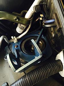

Passenger side:
Bracket is getting roughed up quite a bit trying to shove it against the black metal bracket in the car in order for it to fit.
Major clearance issues on the passenger side where the bracket is far from sitting flush.

Blue circle is the screw that had to be removed to get some clearance to fit the bracket under. Green circle is where the main problem is (I think) for this side. The bracket can't fit with that black bracket in the way. I've tried shoving it in which is causing the GTSpec bracket to get roughed up big time, but there's not much room to get it to fit with all 3 holes lining up....
Am I missing something here?? No way I thought this install would be this much of a hassle. It just doesn't seem like the brackets are made to fit correctly and require a lot of forcing.

For me the AC lines on the driver side had to be nudged a bit (be careful) and then the black lines on the driver side had to be forcefully pushed aside, carefully as well to make the brackets fit in.

Hopefully you can see it now. I did have trouble with the AC lines (is that the metal tubing) but managed to get it to tuck under. It is having trouble hitting the wall close to the windshield and won't budget to fit.

Would help if the pics were working. Mine was a PITA to install as well. The AC lines can be moved if you unclip them and remove the brackets. I do remember having issues with one of the AC line brackets but I think I bent it a little so everything sat flush. That strut bar requires some work to install properly. And yes, you will scratch up the paint.

There is nothing wrong with your GT Spec bar, dont listen to Gary. You need to move a couple wire looms and hoses, and install the brackets separately, then install the bar into the brackets. I installed my GT Spec bar about a year ago with no issues. A few months ago, I had the brackets powder coated, so had to re-install it, again with no issues.

If you can take some pics that'd definitely help. The main problems I'm running into here are that there just isn't any more wiggle room to make it sit in place correctly. The passenger side bracket is having trouble fitting due to it coming against the black bracket shown in the pics (it's the black bracket that screws the hose down).
On the driver side it's the firewall that needs to budge so that the bracket can sit flush. All holes are lined up on that side and it is tucked under that metal hose. Just need to push it down to fill the gap but I'm afraid the pressure will snap that tube since the GTSpec bracket is tucked under there.

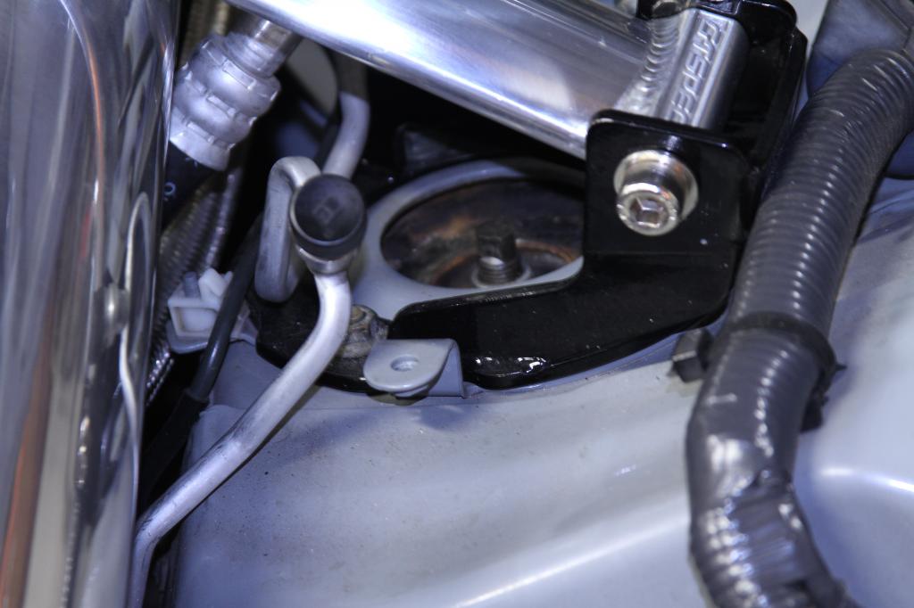

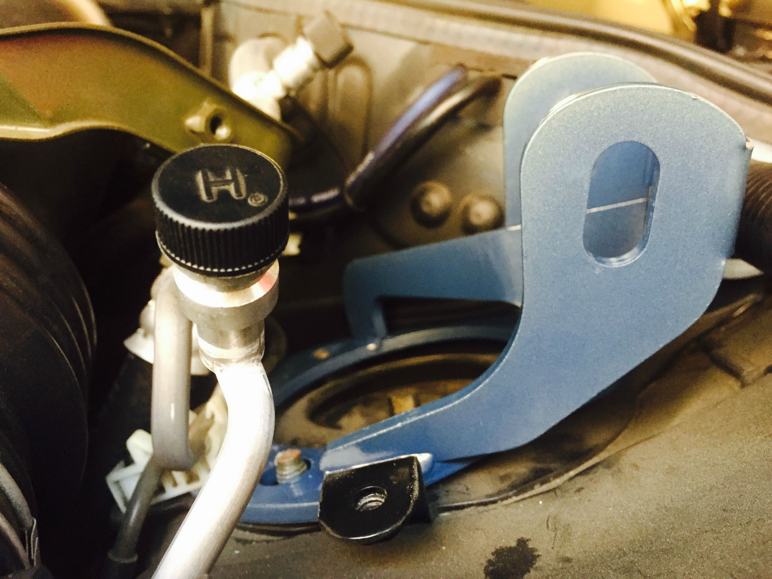

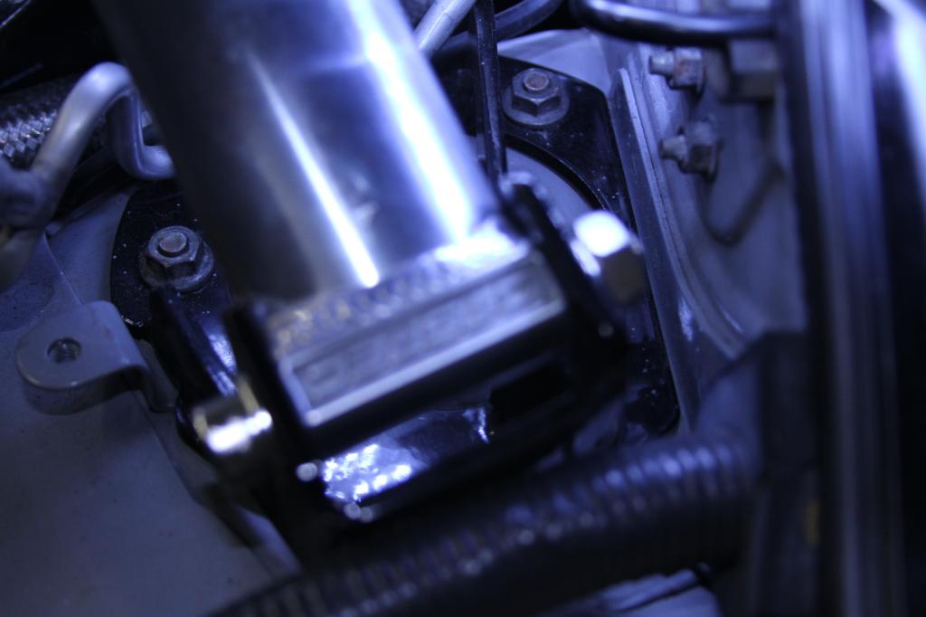

Thats kind of a tricky spot to get pictures of. Hopefully these help somewhat.
And sorry for the wait, I think Photobucket is way slower than it used to be...
First is the passenger side. Are you sure that little tab that's in your way hasn't been bent? Try to bend it slightly towards the front of the car to see if that frees up some space. I guess the same could go for the drivers side.
Here is the drivers side. Are you sure you don't have a hose under the front of the STB bracket keeping it from going down all the way?
Good luck, and let me know if you need any more specific pictures.

Thanks Scott, really appreciate it! I'll take a look and compare tomorrow but it's possible the things you pointed out could be why I'm having trouble. At first glance though, the positioning of my hoses and that tab on the passenger side do not look like the setup in your car. I don't recall ever touching those so not sure why it'd be different...
I'll report back tomorrow morning after checking it out again. Thanks for the help!
