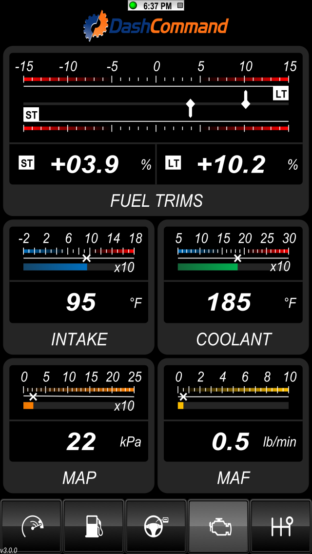

Got a chance today to take a look at the fuel trims, and at idle they were ranging from 3.9-4.7% Short term. Not sure what "scale" this app is using or what I can compare it to?? I might need to try a different software idk.. but anyway here is some pics of highest and lowest I saw. I dont know much about fuel trims to be honest, willing to learn.

The fuel trim levels just show how much air or fuel needs to be added/decreased. Since you're only running between 3-4% you're within specs. If you were at 11% or -11% then I'd start looking to troubleshoot it.
You should have bank 1 and bank 2 readings though, so I would double check both of them.
The a/f sensor is kinda like a more advanced O2 sensor. The two rear O2 sensors monitor the a/f sensors are working correctly. That explains why your voltage in your original posting was misleading.
