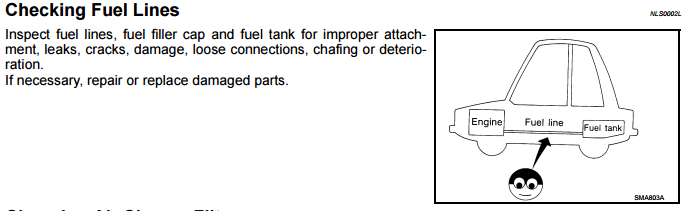

Looked through the Body and maintenance also and nothing really.. This has to be somewhere!
attached.. a funny from the service manual.
