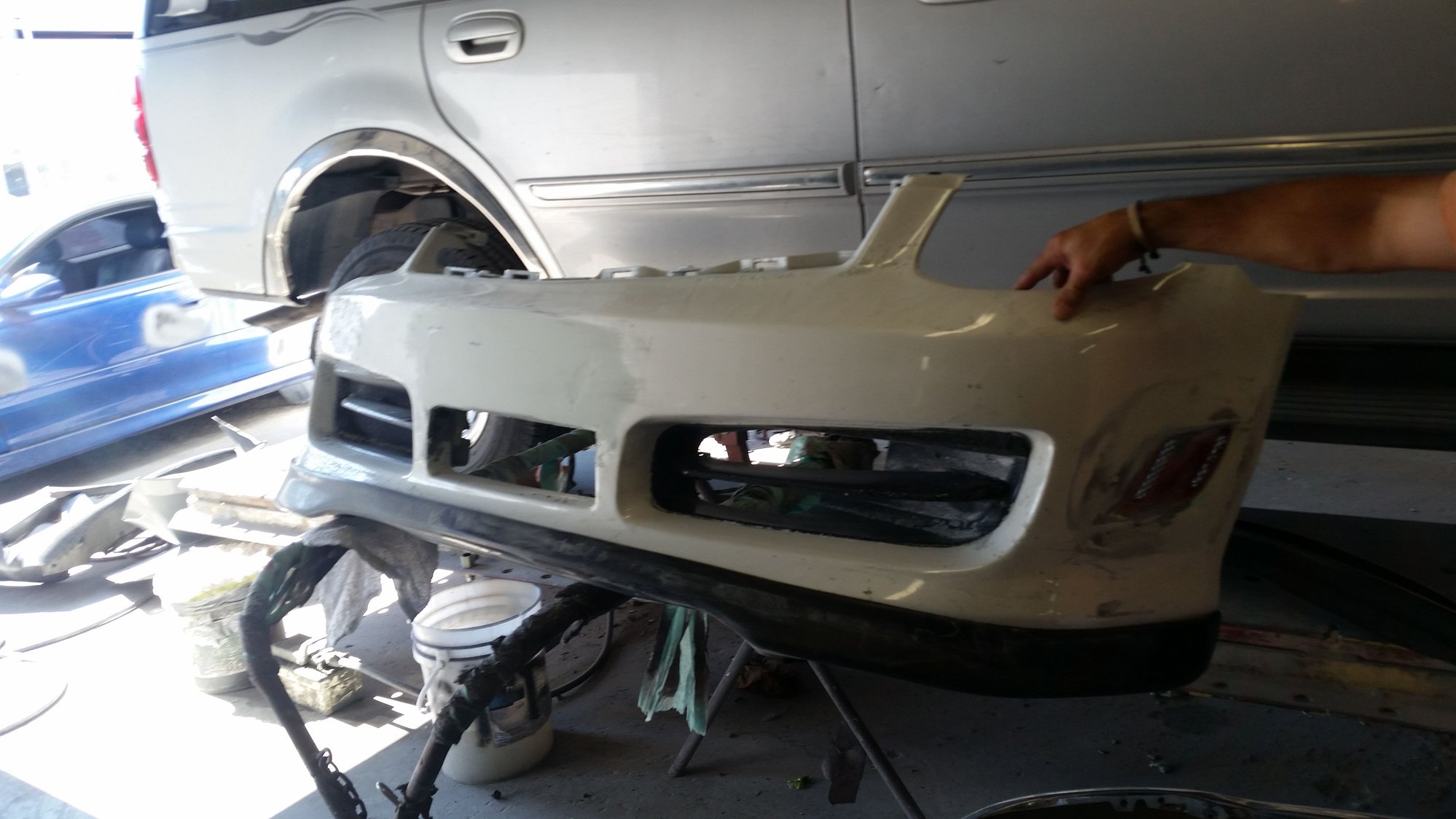

So my car is almost done and I'm thinking about cutting a 4 inch hole in my Radiator support similar to how the 350z setup. My goal it to run my intake directly behind the grille. I have the mesh front grille so you will be able to see the color matched pipe and filter behind black mesh which is my goal, I'll have the make a rain guard like the Stillen kit as well. Does anyone have a similar setup or any concerns that you may have that I've overlooked. I live in the desert and it's not my daily driver so water really isn't a concern. Let me know your thoughts or tips, thanks.

I'm not looking for power gains at all, it won't even be on a VQ motor for long. I'm going for the visual aspect of it behind that mesh grille that I have. The Z has a hole in the radiator support and is l retry much the same setup no structure will not be compromised on the support. And as far as the rain mentioned above being In the desert here its not really a concern. Thank you both for the input I really appreciate it.

Thank you for the response as well as the link. On my car I just want it for looks, my baby won't have a VQ motor much longer since the LS is about ready to drop in, my car is already pretty crazy as far as the body goes so I think that a mango tango intake pipe would pop behind the black mesh grille and finish off the look that I am going for. I understand I won't get HP gains from this mod but it sure will look nice (in my opinion) so I'm just trying to figure out how to do it.
The grille looks like a horrible fit but it just isn't installed and the bumper is just hanging there as well. The car will be mango tango with the entire grille black plus a few highlights in black throughout the vehicle. So I hope that pipe will pop behind there. Thank you all again!

Still working on the grille delete and side vents on the bumper as well.
