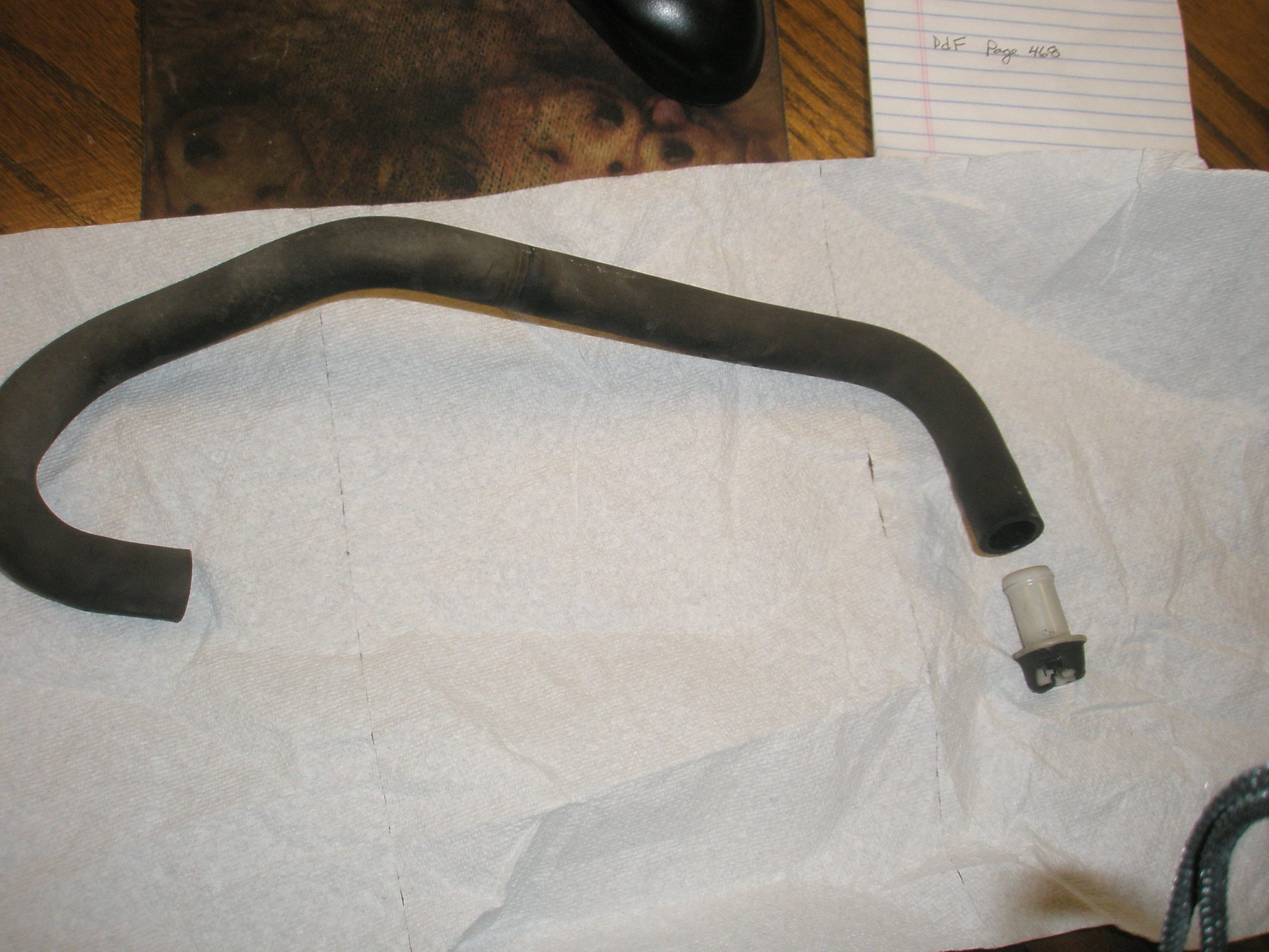

The fitting the vent control valve hose attaches to appears to be broken. The previous owner must have reattached it using a tar like substance. It looks like the substance broke down over time making it loose. I wonder if I can get the fitting from the dealer or will I have to reattach in a similar manner.

Ordered white nipple from dealer $2.00. Hope it fixes my P0456 problem.

GL. I would have went for JB weld or something that wouldn't break down from fuel vapors. Thumbs up for doing it the right way lol.
