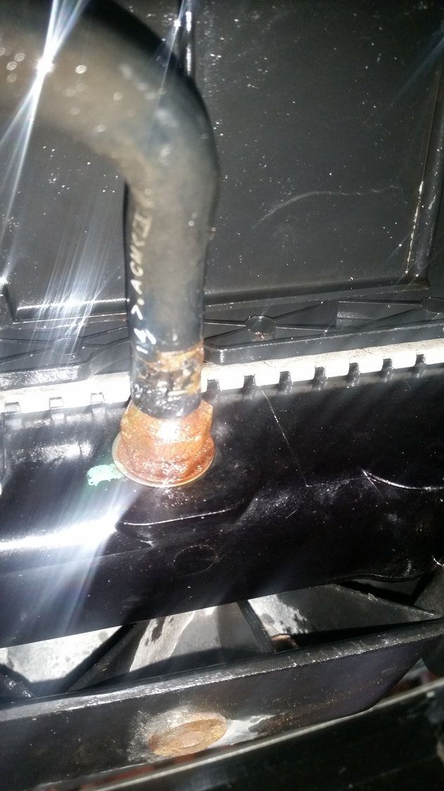

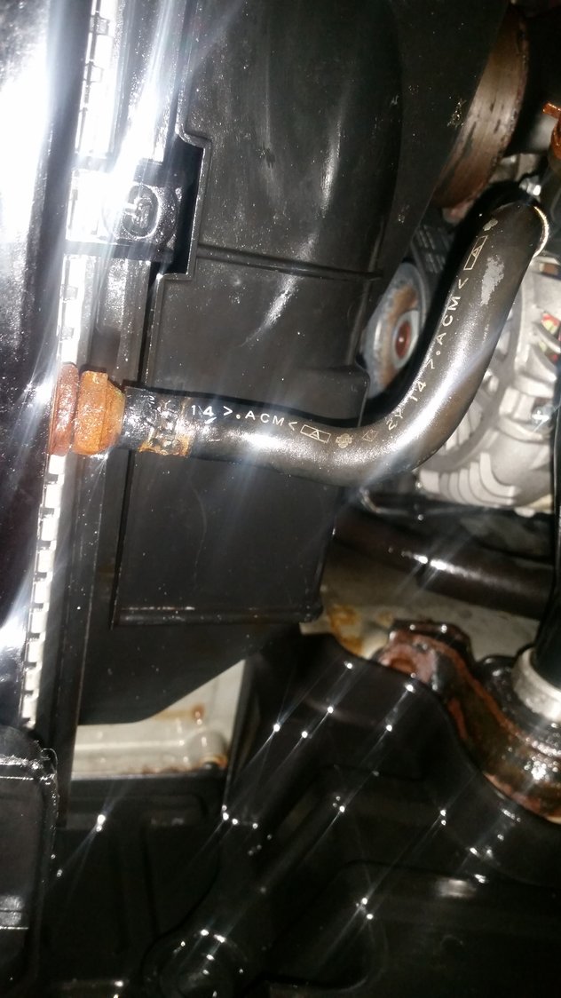

So my dad's Jetta battery died because it was getting old, he called me while I was at work to ask if I was available to jump start it for him, the next morning I pull my 03 g35 sedan 5at out the garage and as soon as I put the car face to face with the Jetta I noticed a huge oil leak happening under my car. Immediately I shut the car off and investigate where it's coming from. I take the undertray shield off and noticed that a hose has been disconnected from what I believe is the oil cooler? The cause of this was a rusted hose clamp which eventually broke and somehow the hose came off and leaked a puddle of oil on the streets, it didn't come off in my garage because the floor was spotless so it must of happened within the 10 seconds of me driving it while pulling it to the front of our house. I filled my engine with 1 quart oil so I could drive it back in the garage for a bit, later I checked my oil level multiple times though he day and it says it's a little above H so I drove it a bit, I've noticed that when I accelerate I need to press the gas more and it doesn't really get up to speed right away I'll be in 3k rpm and it would finally shift the gear so it feels like the gears have been slipping.
My question is did I break something internal when I lost some oil or did I just loose transmission oil and that I should drain and fill? Here's a picture I already replaced the hose clamp
This is by the passenger side

That is the line for the transmission oil cooler. Not motor oil.
Depending on how much you lost, the transmission could be damaged already.
