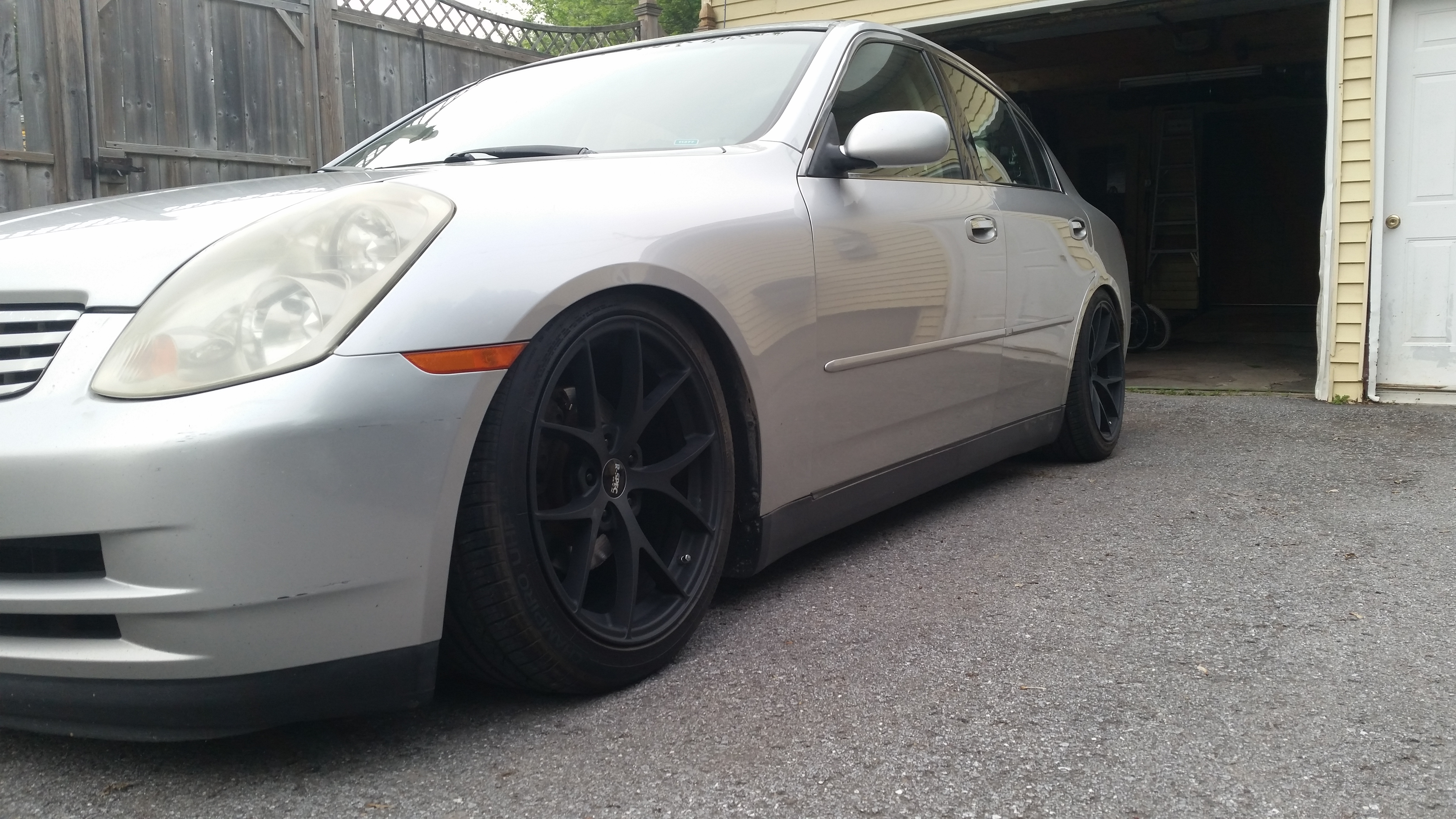

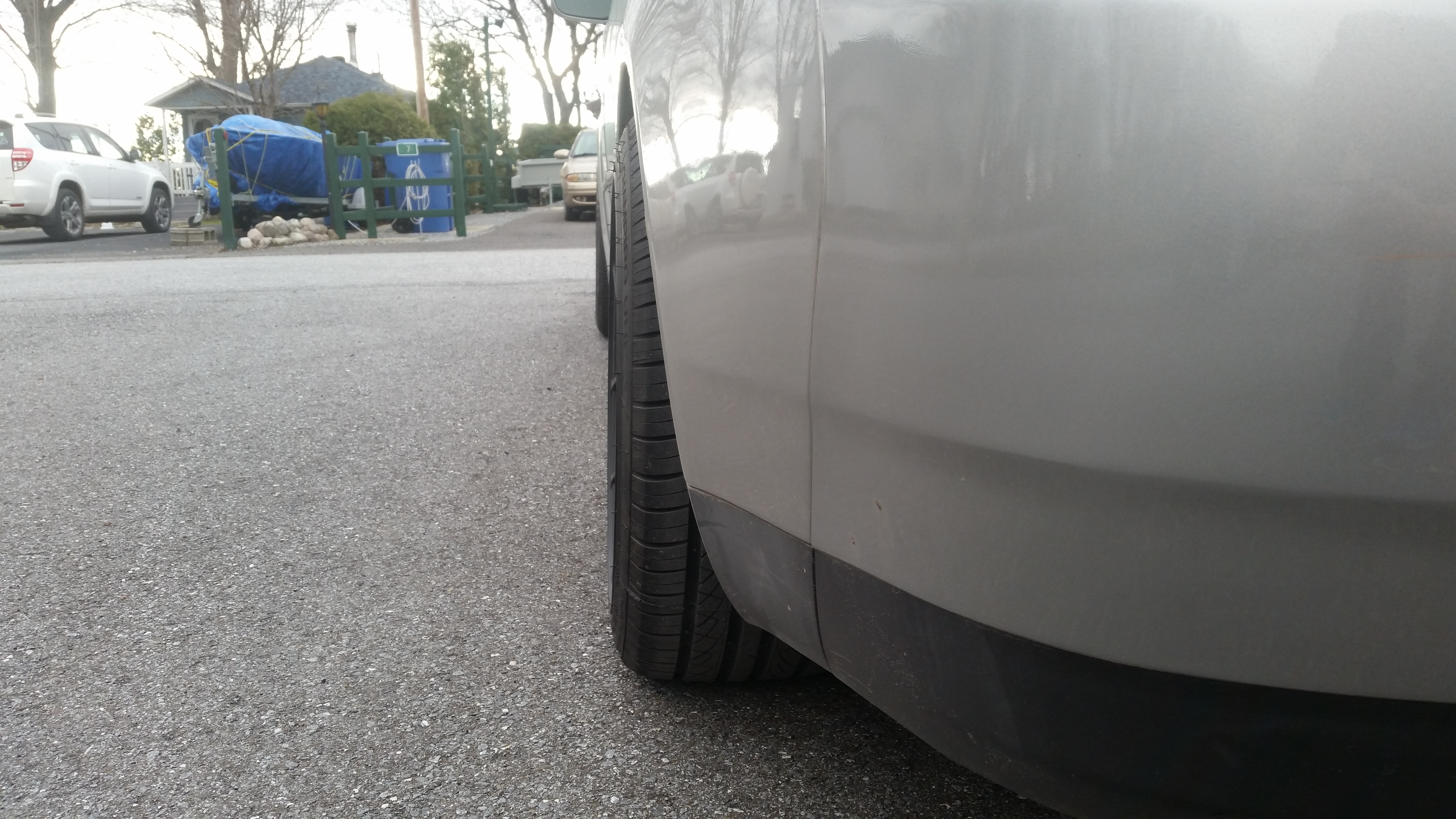

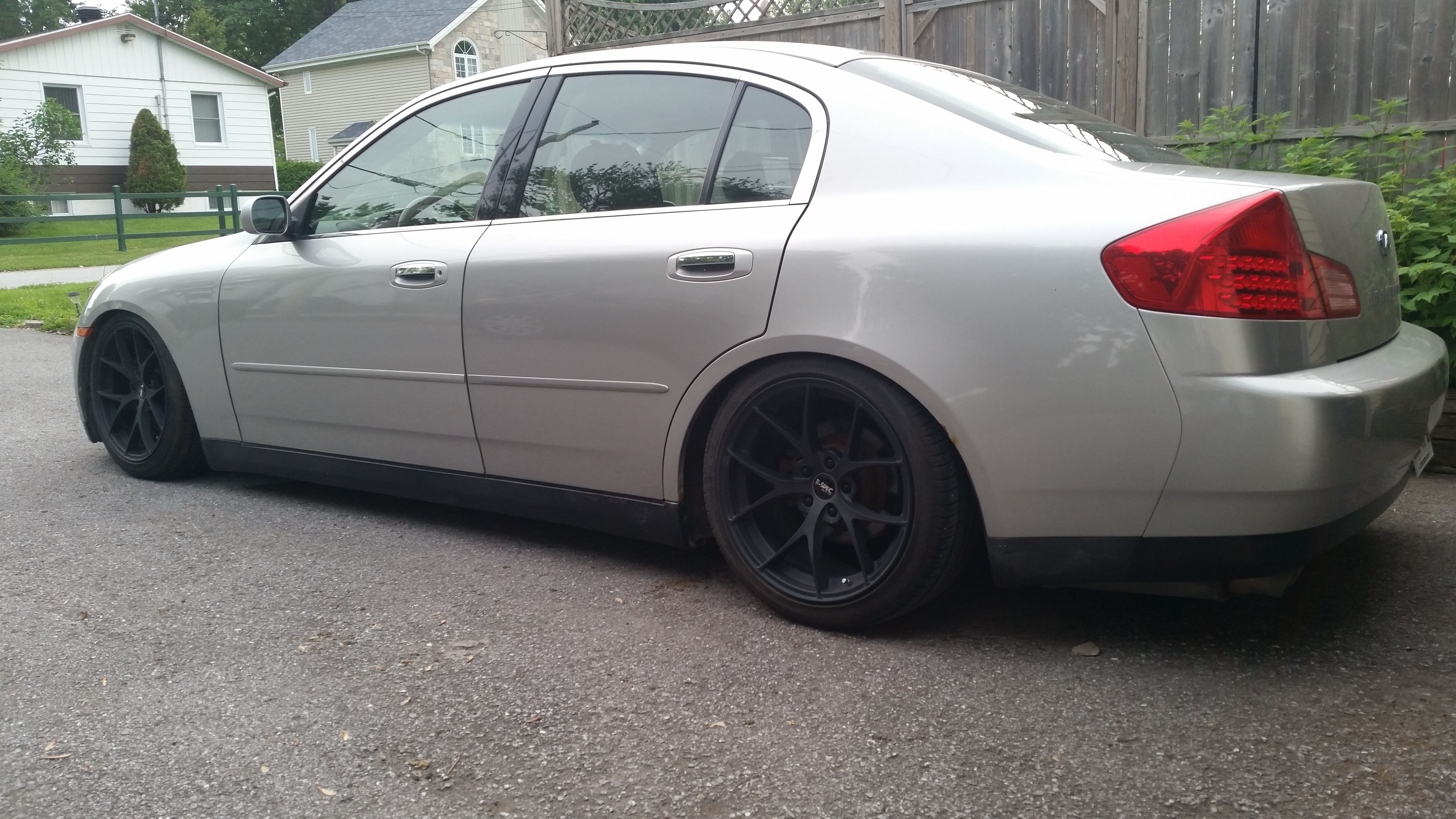

Alright guys probably been done here before but I'll try to keep you guys posted on my build. Have a pretty much stock 03 5at g35 sedan and planning my mods .
So here's my list
Warm air intake : done
5/16 plenum spacer : pending
Wire tuck : pending
Resonated test pipes : pending
Hr y pipe : pending
Custom center pipe : pending
Skunk2 mega flow 3 inch muffler : pending
Modified 350Z suspension : done
Rare jdm wire harness cover : pending
Wheels and tires : done
Blacked out grill : done
Blacked out coolant and ps tanks : pending
Pulley set : not decided
I am a mechanic but I'm pretty sure all the things I've listed can be done withing a weekend one tackling one mod at a time I will try to keep you guys posted as I advance
Ps sorry for the dirtyness of my car but I was to excited to see it lowered
Attached Thumbnails 03 g35 sedan projet diy-20150614_200156.jpg   03 g35 sedan projet diy-20150614_200236.jpg

Want to know what you guys think? Would you guys add or delete some mods I'm planning just making sure I'm going in the right direction

I think it looks good so far. What do you mean by modified 350z suspension? How did you modify it?

What are the specs on those wheels and tires?
rim diameter, width, offset and tire size? Thats pretty close to the fitment I'm looking for.

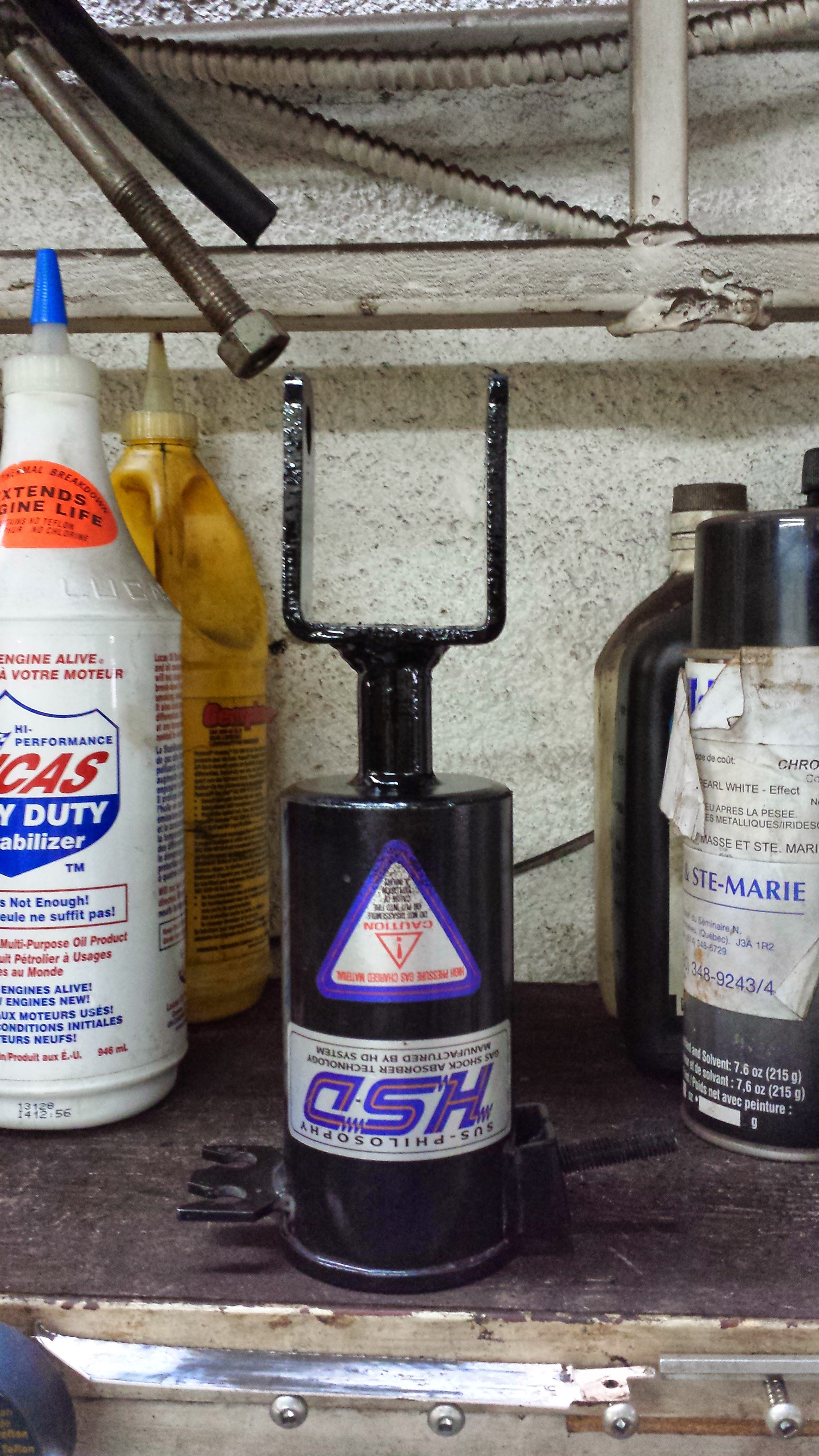

Well on the bottom of the front struts there is a shaft that's 3 inches long with a fork on the bottom to bolt to the control arm since I found the 350z suspension to high I cut the 3 inch shafts to 1 1/2 inches and welded the fork back tu the shaft thus maintaining spring rate and shock of the 350z. All in all I think it was a little over a 3 inch drop from stock
Ok from what I remember front rims are 8.5 x 18 zero offset running 225/45/18 and 9.5 x 18 +35 offset running 245/40/18 but I find the front tires are missing a bit of stretch so next time I will go with 215/45/18 instead and might add a 1/4 inch spacer in the rear that I have lying around

Here is a pic i snapped with the 350z non modified suspenion it gives an idea of how it really looks

Originally Posted by bleupoud
well on the bottom of the front struts there is a shaft that's 3 inches long with a fork on the bottom to bolt to the control arm since i found the 350z suspension to high i cut the 3 inch shafts to 1 1/2 inches and welded the fork back tu the shaft thus maintaining spring rate and shock of the 350z. All in all i think it was a little over a 3 inch drop from stock
wtf!!

Originally Posted by danoman32
wtf!!
Here the first one I did on a friends hsd coilover
