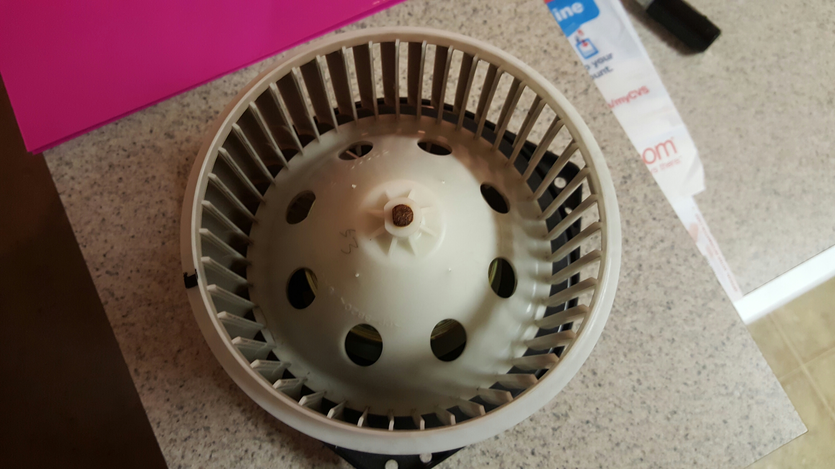

Hey guys I have an 06 sedan AT. Last week I started hearing this squealing noise intermittently when the ac was on. I found out it was my blower motor. I took it out and inspected it and it seemed fine. I spun it with my finger and it spun without a sound. I also made sure there were no leaves or debris stuck in there. So im thinking about lubricating it and if that doesn't work then I'll replace it. The ac works perfect by the way. Now question, where exactly do I have to lubricate it? I can't figure it out.

There really isn't a lubrication point on a blower motor since it is an electric motor. It uses a sealed bearing that once it is bad replacement is more than likely required.
Thank you! No wonder I couldn't find how to lubricate it. Lol. Ill be ordering one then.
