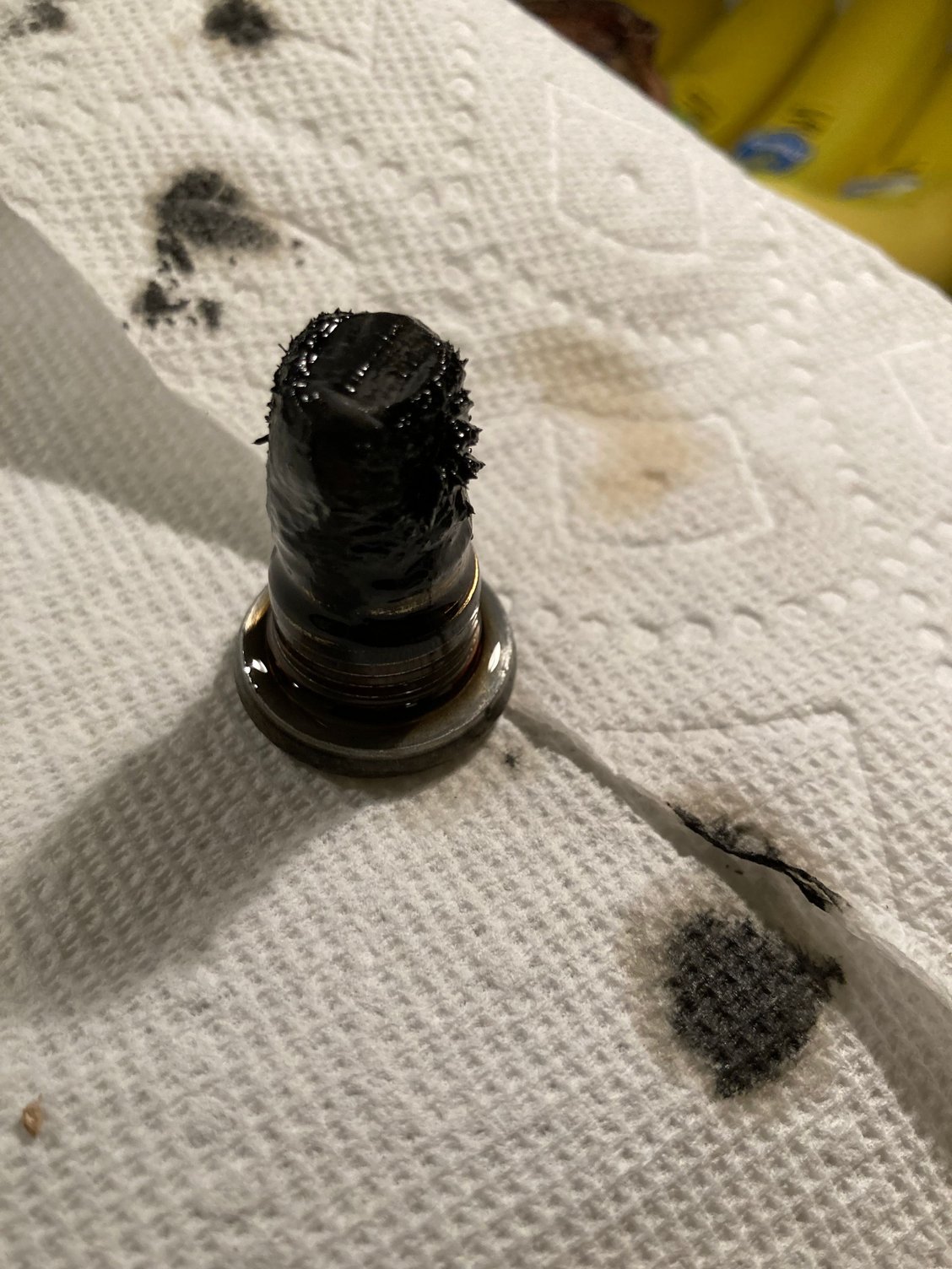

I changed the differential fluid this weekend. I have a 2006 G35 coupe with a standard diff (not LSD). The drain bolt magnet collected a gnarly metallic sludge. If you haven't done so in a while, change the differential fluid.
1.5 quarts capacity.

Looks like roughly 75k-100k miles between fluid changes. If so that would be a "normal" accumulation of sludge and metal.
