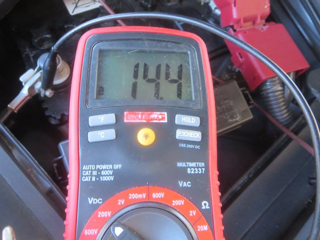

Front and rear cameras, tire pressure for all four tires can display on screen,folding side view mir
Originally Posted by beeps220
I have not but a new belt was put on 2 weeks ago
Check belt tension. They stretch!
Check voltage output from alternator
Telcoman
