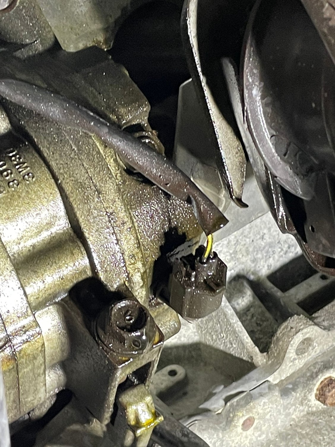

Old Dec 21, 2022 | 12:32 AM
vq.krisss's Avatar
Joined: Dec 2022
Posts: 3
G35 Sedan 5spd
Have the same leak.
Did you end up finding where the leak is? I just got this leak on my 2004 G35 Sedan and I'm scared to let her go because of it. did my valve covers and gaskets and may have to recheck them but if it's the rear main seal I'm screwed.
leaking on the backside/motormount
entire angle
on A/C compressor so it's from above

Check your engine oil dipstick. Check if it is seated correctly. That was my oil leak issue, oil was found in the same areas, identical to the images you uploaded.. Lastly, look over the seal on your engine oil dipstick. The seal will deteriorate over time, and you may need a replacement. I hope this helps.
Old Dec 21, 2022 | 11:08 AM
vq.krisss's Avatar
Joined: Dec 2022
Posts: 3
G35 Sedan 5spd
I'm just confused because the (oil) doesn't have a scent and if so, I might just buy one to see. It could be the dipstick as I check my oil frequently.
Old Dec 21, 2022 | 11:28 AM
Gt_2ner's Avatar
Joined: Jan 2008
Posts: 39
From: San Tan Valley, AZ
I recommend de-greasing and cleaning your engine. It will be much easier to identify the source of your oil leak with a clean engine.
