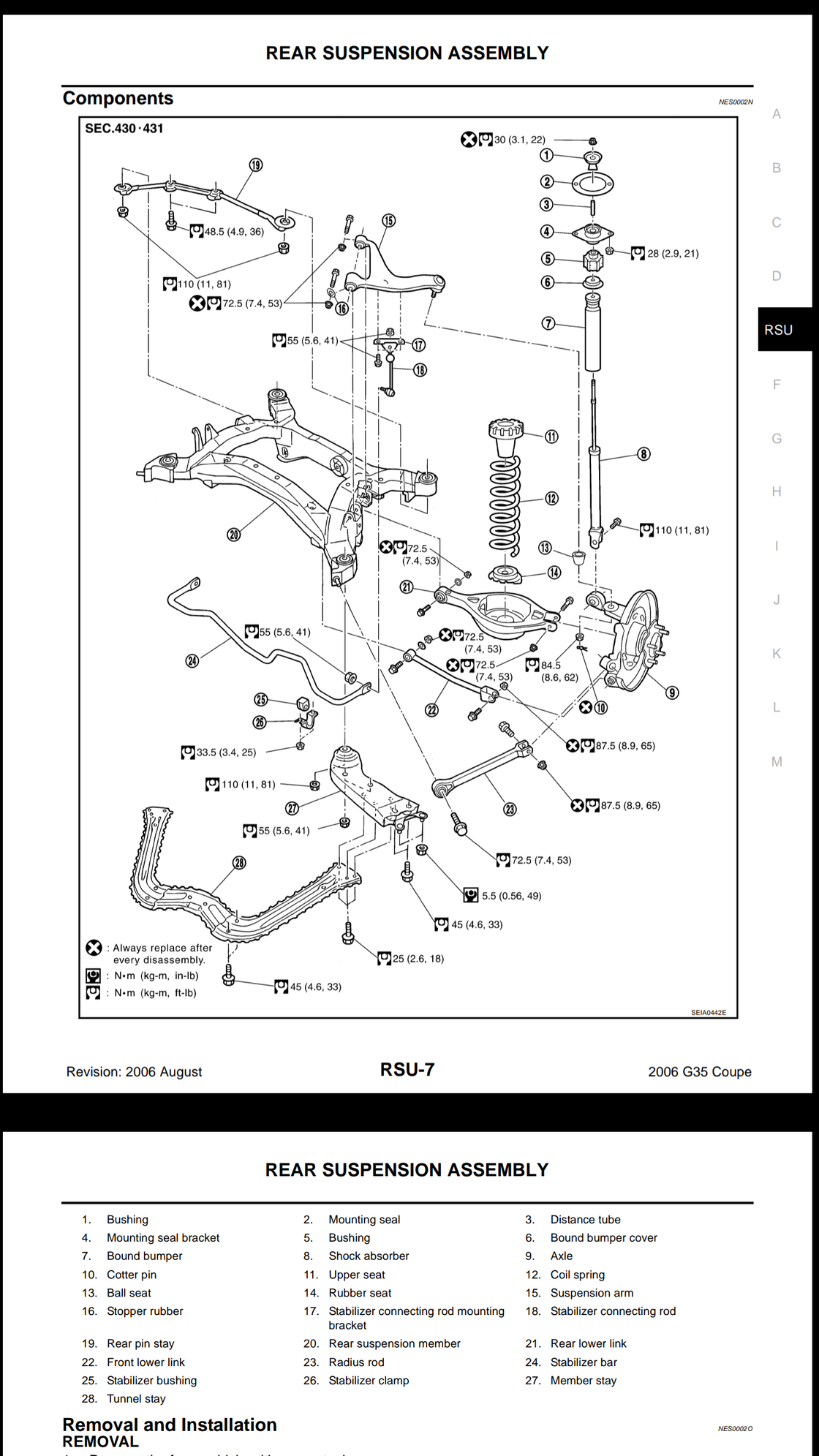

6. Where can I find the suspension schematic for G35.

6.Ill see if I can post a couple pictures for reference.
