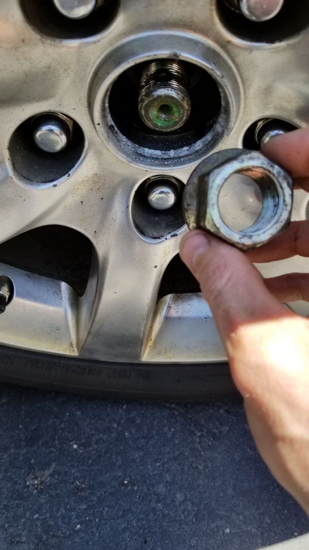

How to install ABS portion of CV axle.
Turn wheel
Remove cap
Insert
Replace nut
Make codder pin from heavy wire
