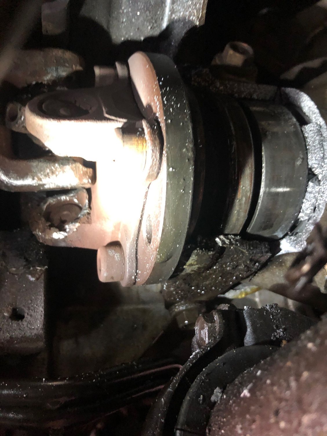

So, i finally have a chance to finish off for inspection after having the u joint ear on drive shaft that eroded. Other than a a small wear area on transmission case, a replacement driveshaft and patch, everything appeared fine. On moving it, it took a few convincing nudges to get it going. The car didnt move freely, as she moved the better she got. After a few laps around the block everything seemed fine except a slight vibration and not sure if its driveshaft/differentials or just a rotor issue. but having had the drive shaft shear and flop around, wondering it did some other damage.
I'm going to be pulling each wheel and clean brakes, rotors, replace wipers and 3rd brake light in wing for inspection, but would like to get my smooth ride back.
Any ideas on checking differentials?

G35x front diff.
To remove the diff.
You will have to remove the Y pipe, Passenger cat, remove transmission cross member, remove front driveshaft, remove driver and passenger side spindle and axles, remove intermediate axle (goes through oil pan into the diff), Passenger motor mount and bracket, at least drop the engine subframe 3-4", drop the steering rack (can leave lines attached). I'm not going to lie it's a lot of work and a little rough fishing it out and in with the engine subframe in the way. I will probably pull the subframe out from now on since it makes the job so much easier and less chance to screw seals up.
About your diff bearings. If you are changing the diff bearings I hope you know how to use gear marking compound and setting gear lash because if you get it together wrong it is going to sound like an airplane when rolling. I would just replace it with a low mileage unit. My diff was $150 shipped and had under 100k miles. It looked brand new inside. Just make sure to get the 03-06 G35x diff because the 07 up,G37, and suv's have a different ratio.
very nice vid! did the oil pan get damaged during this carnage at all? looking at '06 m35x with this issue and from the pictures the guy sent me, it looks like the u-joint did a lot of roundhouse kicking in that area.
