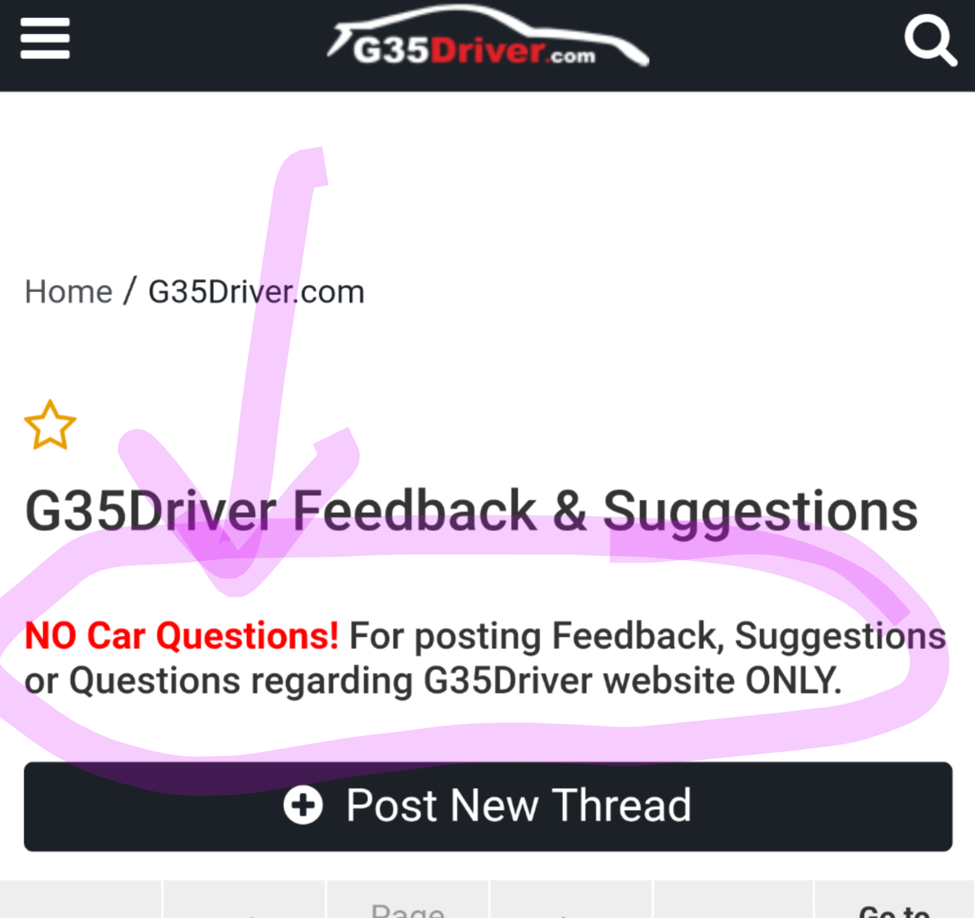

Please post in the correct sub-forum. I'll try to move this thread if this sketchy mobile internet will allow
