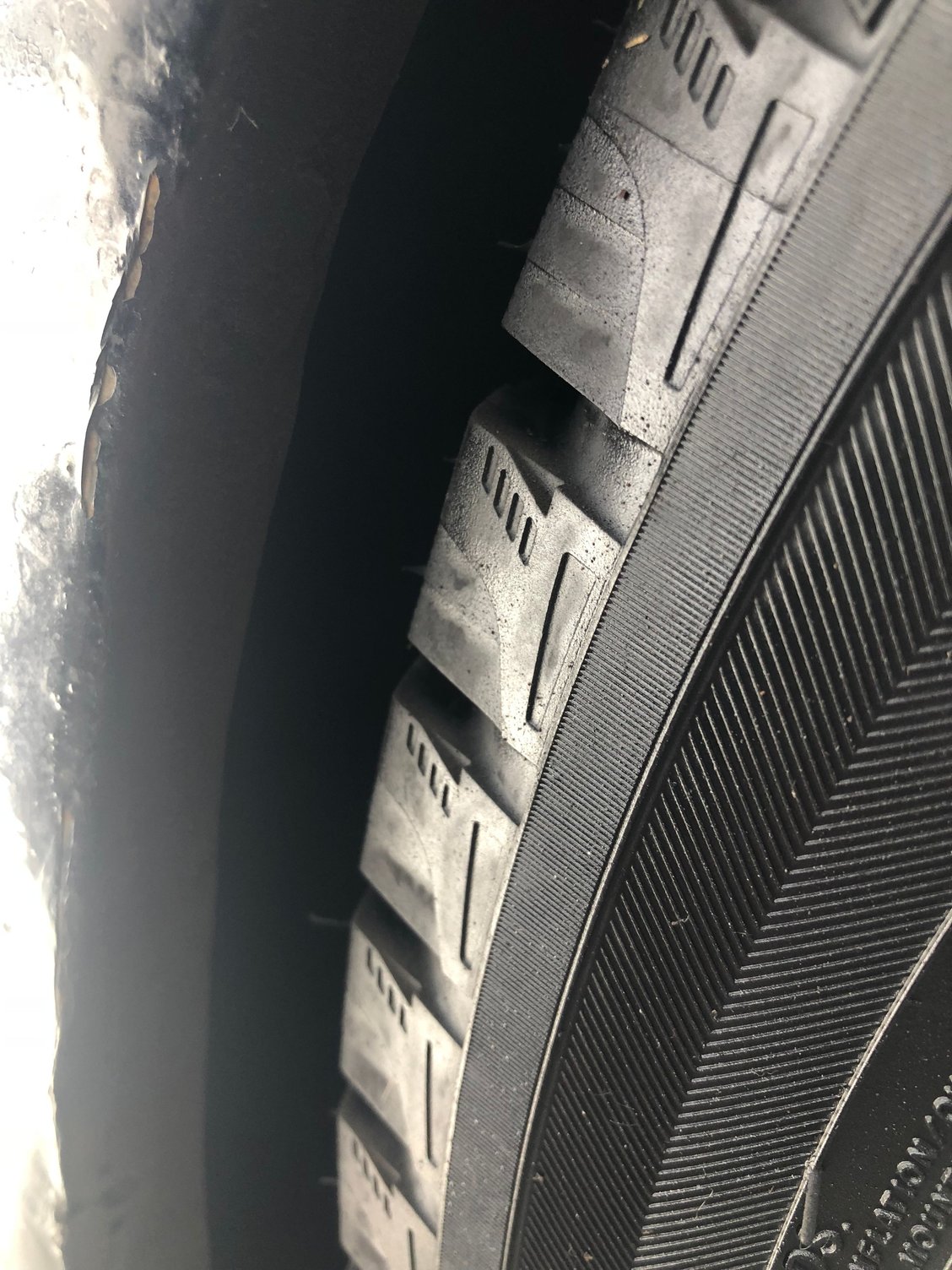

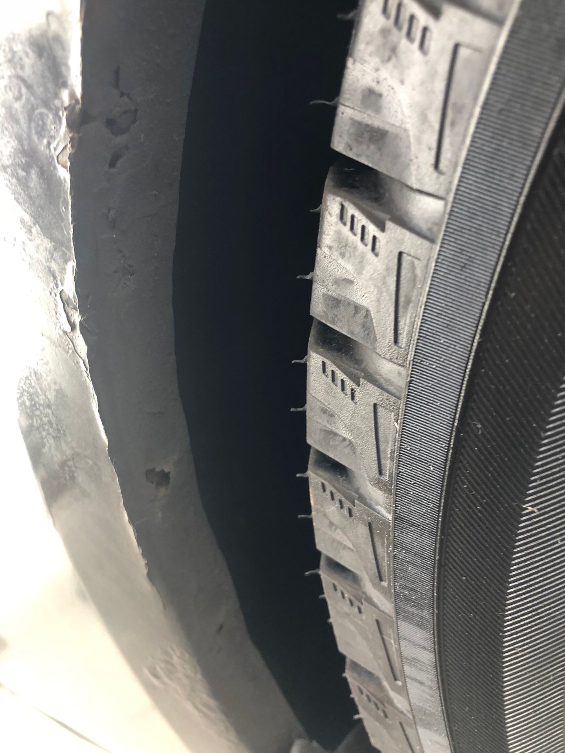

@cswlightning here is how my fenders look now the last pic was in the summer

Definitely not cause for replacing the quarter panel, but might be all the way through in a couple places. I see why you're going down the arches route, if I were you I would spend a day to remove the rust and do the prep work to save hundreds of dollars and make sure its done right. All you really need to do is get a power sander (or even a sanding block and sandpaper) and just grind all the rust away with a grinder or even sandpaper making sure you get it all. From there all you really need to do is paint everything that was rusted in a nice layer of POR-15 and it should never rust again. Also check under your side skirts and conduct repairs there if needed. Finish by emptying a couple cans of fluid film into the internal cavities to stop the progress of any other hidden rust holes that are likely in both of our cars.
After that all the shop would have to do is cut the flares to size and bolt them on, covering up your work and making it look pretty again. Should take them an hour if that. If you cheap out at the shop they'll just bolt it on over the rust and in 2-3 years of winter use you'll have a basketball sized hole in your quarter panel showing past the flare.

You won’t recommend just cutting off the current fenders and drilling on the new ones? The flares are already precut

I have to agree with cswlightning here. The last thing you want to do is pull those overfenders off in a few years time and have worse damage

sounds like a plan though I’m not sure how I’m going to be able to roll it either way.the reason why I’m cutting my fenders off is to fitnbigger wheels and even if I sand all the rust away,the major rust is still hidden under the fender line (under the wheel well) and therefore won’t be able to roll.
