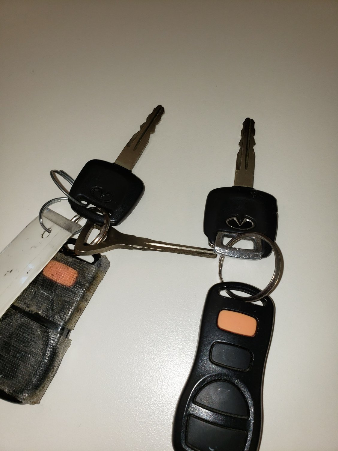

Hey guys recently upgraded to an 04 G35 after my 03 got wrecked. Bought it about a week ago. When I bought it the Key Fob didn't work. Bought new battery for it and nothing. So I've just been unlocking the car with the key. During this time the anti-theft light on the dash has been off. This morning however when I got in the car the Anti-Theft light started flashing and when I went to start the car it just started clicking and not turning over. Would this be the anti-theft disabling the car or is it just my starter that went bad?
Thanks for any help!

Have you ever started the car with this key? The key is chipped and if it is not programmed to the car, it will do this. How many original keys do you think you have?
These are keys I was given when I bought the car.
I've been using the one on the right to start the car since I bought it.

Ok, the physical keys are likely original looking at the pictures. The chips are embedded in the body of the key itself.
The button fobs won't have anything to do with the car not starting, so let's disregard those (they are also easy to reprogram).
