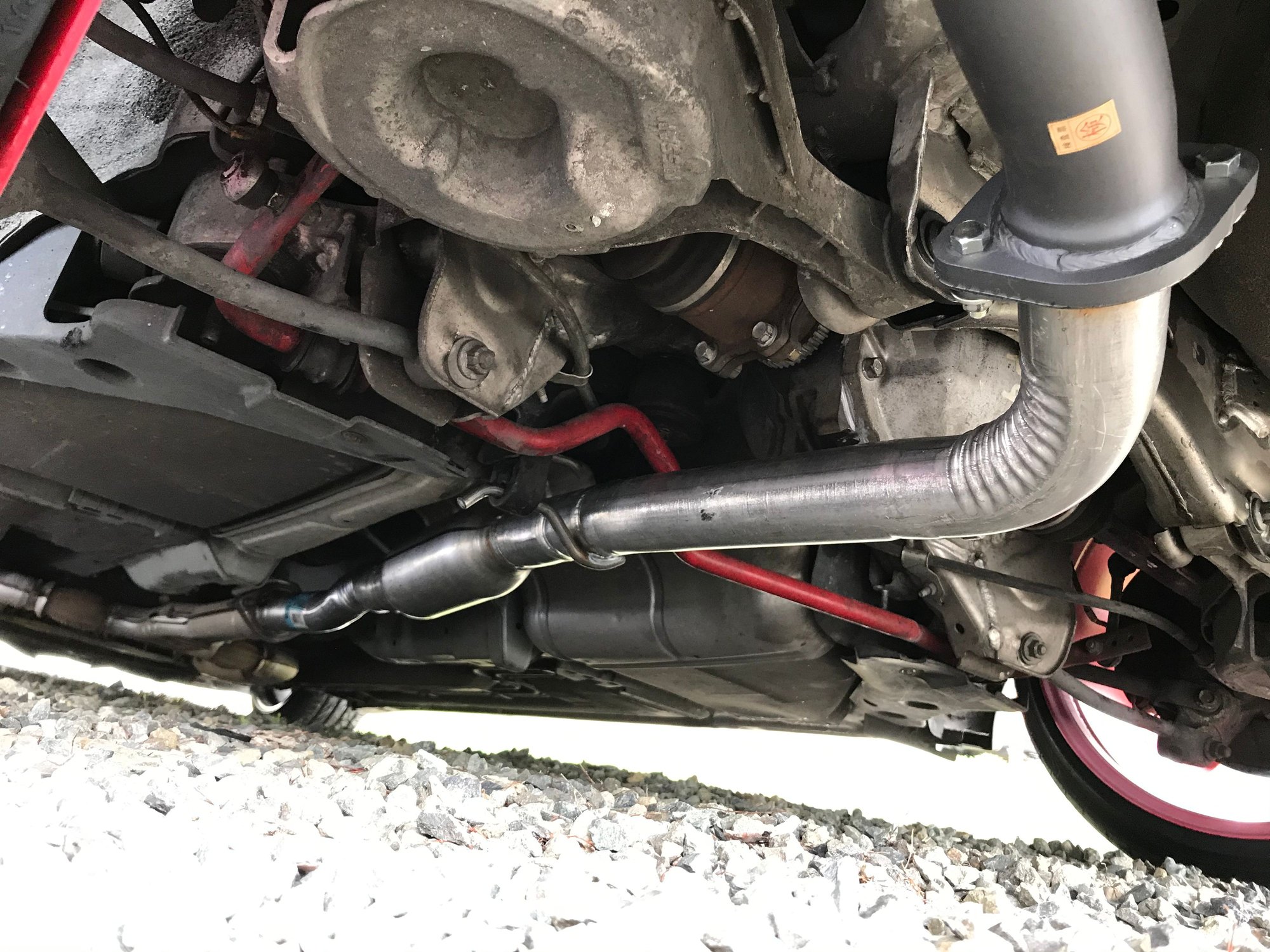

I added the coupe mid pipe to my G35 sedan, also installed an HKS muffler. Made a HUGE sound difference and it also saved a bunch of weight! I went with a "Walker" Mid pipe and it fit perfectly!

Drifter, using a scizzor jack on gravel is absolute cringe...
Totally, I added a metal plate to the bottom but yeah, not the wisest decision. I had jack stands under while I was working though. Only place I could work on it and the yard didn’t seem any more stable and the street was possible either.

Thanks for the pictures, I didn't think a coupe setup would fit on a sedan
