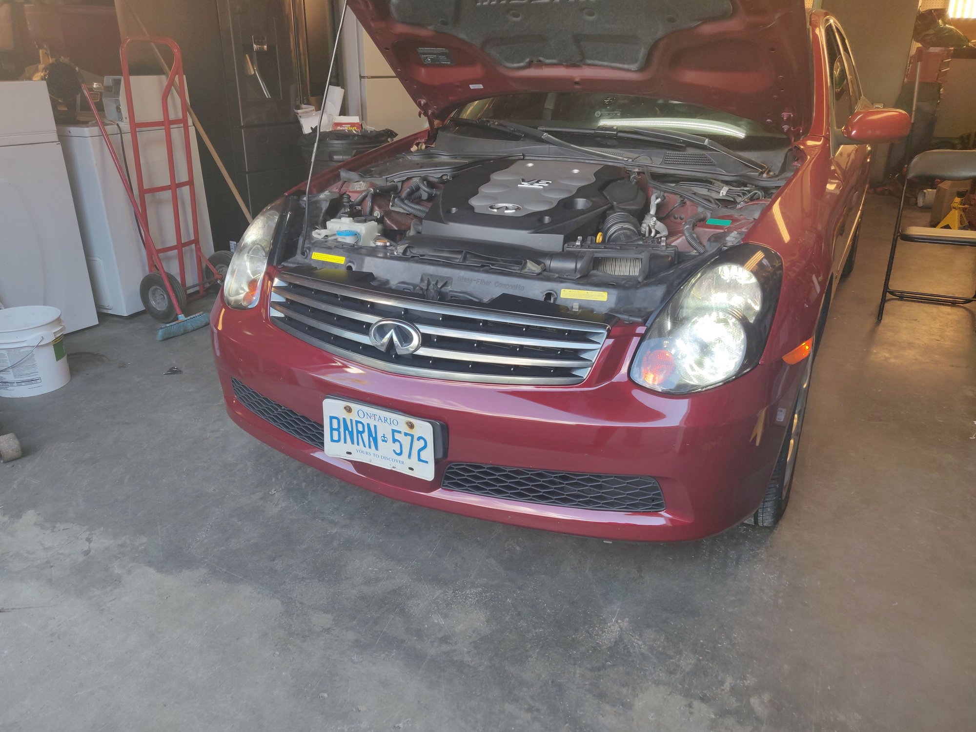

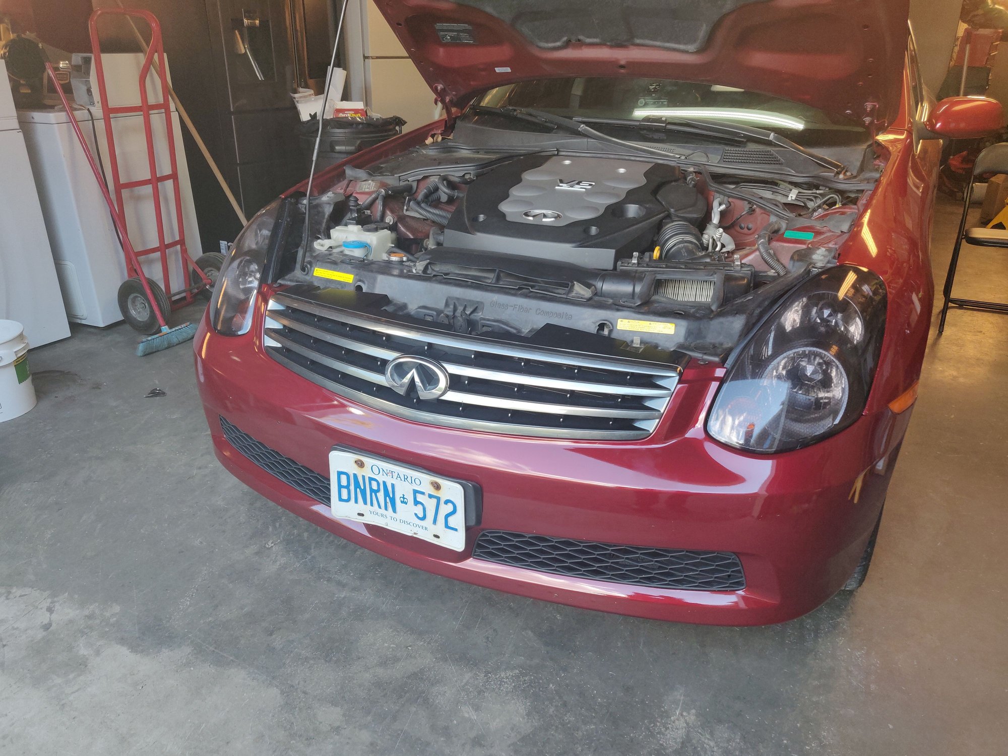

Hey guys, so i just got my bumper painted and installed it yesterday. While doing so, i swapped my daytime running lights to LEDs to get rid of the disgusting yellow colour.
However, my DRLs stopped working now. The highbeams work, so i know the bulbs are fine. I have previously repaired the module by resoldering it last year. I just took it apart and redid them all again to make sure. Still no DRLs.
I havent torn off the bumper again yet because i dont want to do all that work for nothing because my DRLs were fine before i swapped the bulbs. Again, the highbeams work but the drls dont for some reason. Could it be the LEDs cant run at such a "low voltage" if thats the correct terminology?
The kit i used and have used many times on other cars are LED EAGLE off of amazon.
Any ideas or solutions? Wanna get this sorted so i can finally put my ionic lip on!!!!
