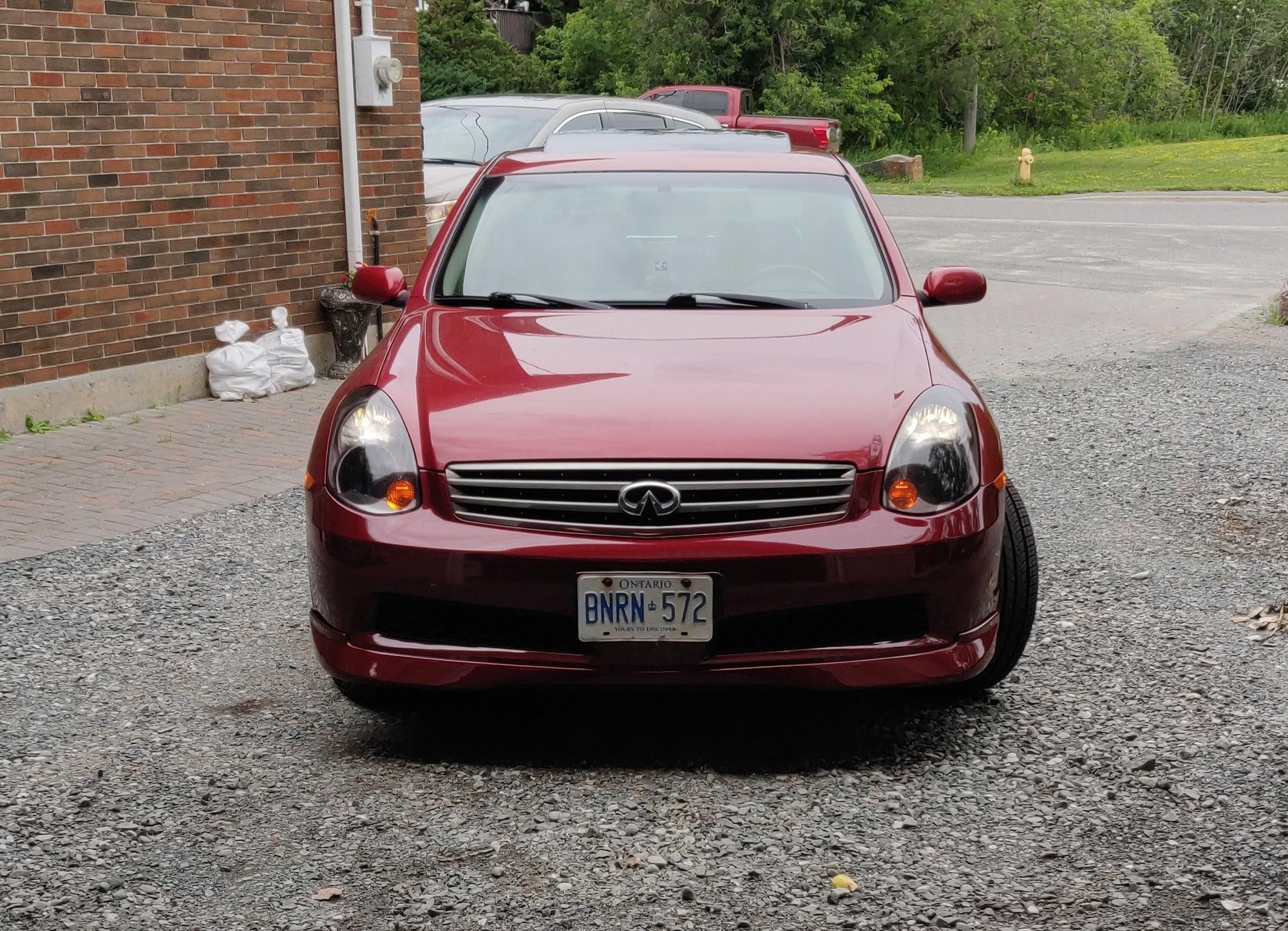

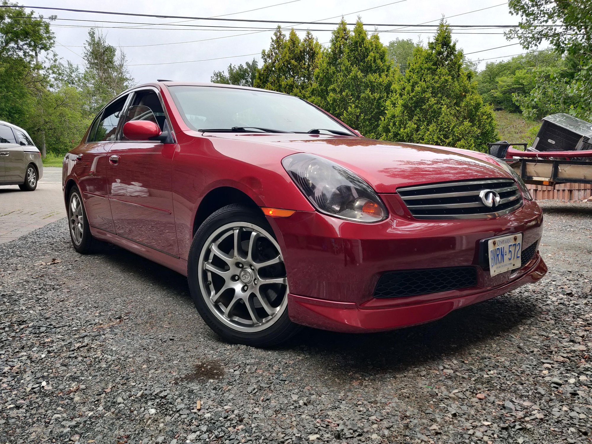

These are the aftermarket headlights I have on my car. I have it wired up so that the halos and LEDs come on when I turn the car on. They stay on at all times, even with the low beams and high beams on.
U can wire it up any way u want it to work. As long as any of the lights gets 12v power, it will turn on. Anything is possible, but u gotta figure out which wires to cut and which wires to tap into. Its not something thats easy to explain online. And since youve never done this kinda stuff, I would recommend u have someone next to u thats more familiar with wiring things up.

I have a couple questions for you. How is the fit on the ionic lip? I've been contemplating ordering one for a year now.
Exactly how does it hook up to the front bumper? I don't have the undershield on my sedan, and the two corner pieces that are attached to the wheel well plastic and the bumper are smashed up.
For fitment, two self tappers in each wheel well into the front bumper. Then 7 nuts and bolts into the bumper. It fits "in front" of your undershield. All hardware is given. Instructions for install should be given, but i didnt have any. Simply emailed and he sent me some a few days later. Basically, you dont need any of your "shields" because all the bolts/screws are into the bumper.
You have to drill holes underneath the bumper. I recommend a friend help hold it while you mark the holes because i didnt and the lip kept falling off and i made a couple mismeasurements.
Its fairly straightforward once you mock it up. I used tape as per their instructions to prevent scratches.
