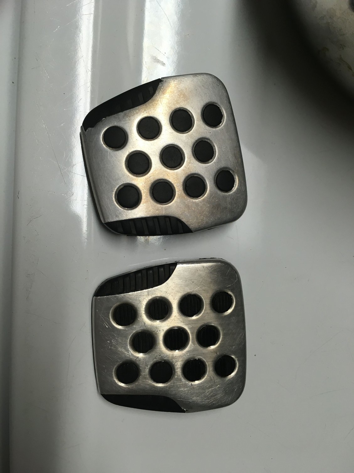

Got these last year thinking they would be a simple mod to spruce up the interior. I was wrong.
The clutch and brake are impossible to put on because they are barely bigger than the actual pedal.
Enough blood, sweat, and tears. I will pay someone to put them on. Don’t trust a “shop”. I am dead serious
Hit me up if you can make it to Stockton, CA
06 G35 Sedan 6MT
Little f**kers

This is a pretty simple install. Just heat them up (don't melt them, hair dryer works or leave them in the hot sun for a bit) and then use a screw driver to help pull the rubber around the metal. Wrap the screw driver in electrical tape if the sides are too sharp to avoid damaging the soft rubber.

Trust me I’ve tried that and every technique on these boards (I boiled them!) I even put soap to grease them up didn’t work. Tried this 3 times already.

Shave the sides off your original pedal.
