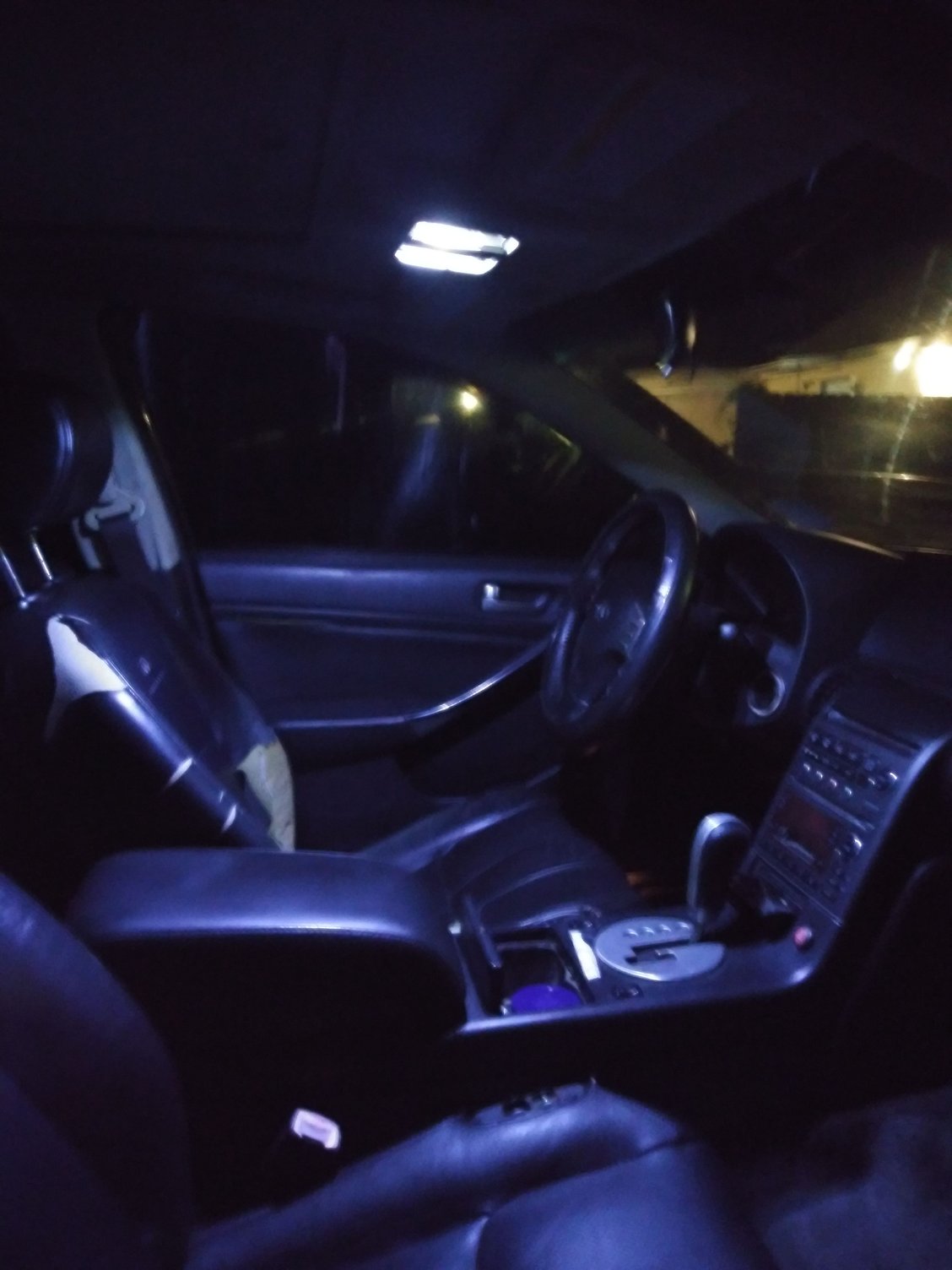

So hi everyone, hope to get to know y'all now that I've been using this resource to help buy my car. I got a 2004 g35 sedan and I love it so far. It's got some minor cosmetic issues here and there, but runs amazing. I know it needs cats(probably o2 sensors) and maybe a crank sensor. I've got my cats on order and wanting to wait to get the sensors until that's done, figure the codes I'm getting might be false positive due to the o2 sensors being disconnected.
I think it has the premium package, no aero. It's got leather interior, heated seats( maybe, at least the buttons) and I hid/xenon headlights. Things I don't have: nav and reclining rear seats. It's also got what looks like a satellite antenna on the roof, but I don't think it has satellite radio.
Some of the cosmetic issues: torn seats, broken trim( dash box cover, ashtray cover, cup holder spring), passenger power seat control is shot, minor dents, yellowed headlights, and the sunroof doesn't go back. Also missing the lens covers for the map/some lights

Anyways, I wanted to ask if anyone knows if the 2005+ g35 dome/map light console would fit in my car? From the pictures I have seen on eBay they look about the same shape and size. Only difference I see is the shape of the lenses and it looks like the new one has a built in mic or something. I guess the biggest question is will the plug work? Also do I even want to swap it out haha.

Ohh sorry didn't realize you were talking about the whole thing. Yes the newer ones have provisions for the mic/handsfree bluetooth phone to the stereo. I assume if you swapped the entire roof console it would fit but I've never compared them.
