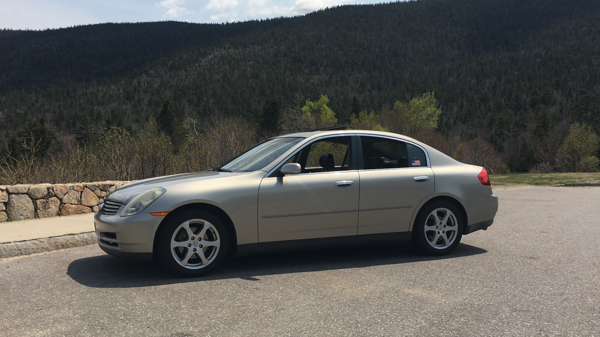

Hello all, I’m the owner of a very nice 2003 Infinity G35 sedan. It’s absolutely rust free, has unripped leather seats, is silver with a black interior. It’s an automatic with 160K on the clock and because I keep up with her, the ride quality is very similar to what I experienced when I bought it in 2016 (five years ago) at 79K. She recently got a new (made in Japan) factory radiator, new Continental extreme contact all-season tires (I run them all year and daily drive the car here in Maine) and a Mobil 1 oil change. She’s doing great. She was recently tuned and got the whole valve gasket job etc. Though I’ve not touched shocks and springs (they are stock and doing fine) I’ve gotten into other suspension components and she’s up to spec in that category.
Brakes are what they are, nothing special but they stop the car and I keep up with them. I also tend to engine brake using my trusty beloved triptronic shifter thingy so that helps prevent wear. The exhaust is stock except for a replaced muffler.
Otherwise the initial quality continues to hold up excellently. This is owing to the rust free nature of the car, that having had to do with it “growing up” in Seattle before I got her and introduced her to New England weather/salt. There are still no flaws in the paint and the chrome all looks so nice still. I have the typical glove box bowing but it’s minor compared to other more extreme examples I’ve seen. And again my driver seat is stock and not at all torn. I think we all know how well built these cars really are. I got no codes and everything works. Even my factory car mats are still nice. Which brings me to cleaning.
These cars clean up well and evacuate water remarkably well if you know what you’re looking for when drying your car. Absolutely no rust/rot anywhere along the bottom edges of this car or anywhere else for that matter. I still love my G and I’m pleased to own such a nice example of a nearly antique auto.

Here’s more of my “bionic cheetah” in the wild.
Those are the White Mountains of nearby NH.

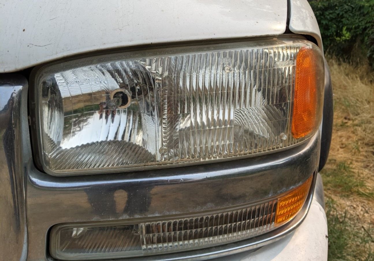

This is a good example of what to expect with age, my 2000 Sierra 2500HD, the headlights were yellowed so badly you couldn't see the lamps anymore, I polished them spring of 2018 (almost 3.5 years ago), they're ALMOST starting to yellow again if you look at the picture closely.
