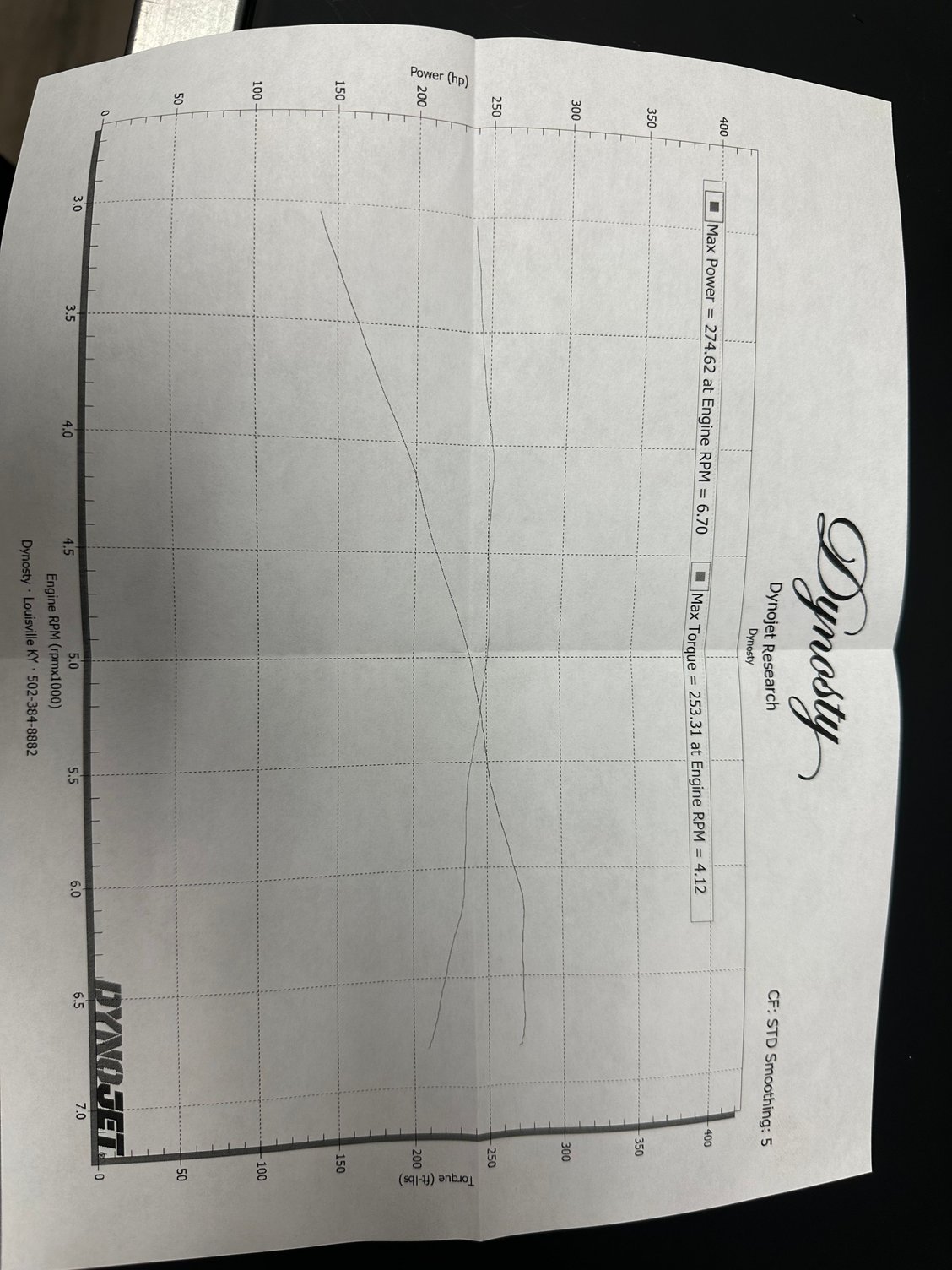

I got everything except the pump itself from dealer. Installed my upgraded 350L pump, had to mod the housing a little to get the pump to fit.
my current Dyno, till the turbos go in.
New engine has 30k miles on it so I think it’s safe to boost her now.
